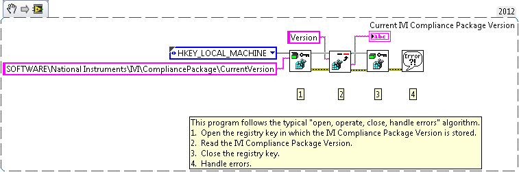

This program may be used to programmatically determine the IVI Compliance Package Version on your current system.
Description
The IVI Compliance Package Version is stored in the Windows Registry.  This program accesses that particular registry key to programmatically determine the IVI Compliance Package Version. This program follows the typical "open, operate, close, handle errors" algorithm. First, the program opens the registry key in which the IVI Compliance Package Version is stored. Then the VI read the IVI Compliance Package Version, and close the registry key at last step.
Requirements
  1. LabVIEW 2012 (or compatible)
  1. Start LabVIEW as an administrator
  2. Run the LabVIEW IVI Compliance Package Version 2012 NIVerified.vi
Additional Information or References VI Block Diagram
 VI Snippet
