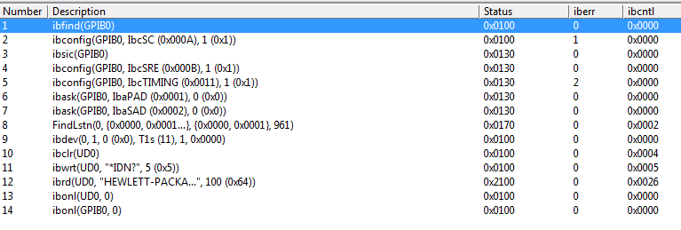

When selecting scan for instruments in MAX, NI IO Trace reveals the following command sequence:

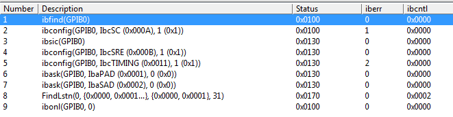

Using an example, findinstruments.c, it was possible to adapt the code to perform most of these commands. This was then compiled into a dll, so that it could be called using the Call Library Function Node. The IO Trace result of calling this function can be seen below:
As you can see, this contains most of the useful configuration steps that would be initiated if you selected the option in MAX.
