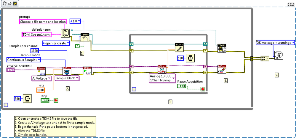

This VI's intended use is for LabVIEW users who like the way data is presented with the TDMS File Viewer.
Description
The data will also be saved to a location of choice while the program is running. The VI is set to acquire one channel but can easily be changed to acquire multiple channels. A limitation of the TDMS File Viewer is large amounts of data. If large amounts of data are taken, it is possible that the TDMS File Viewer will need time to update all the information.
