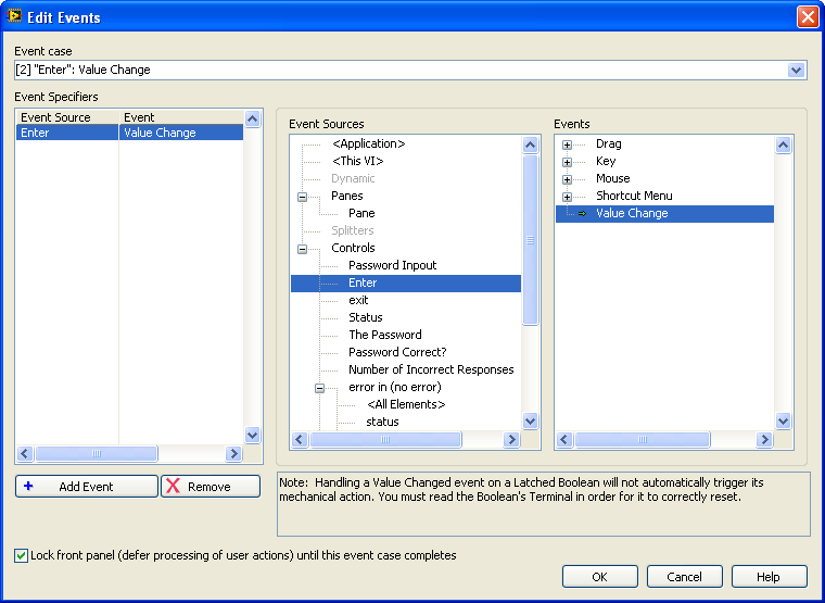

2. Set the Event Structure to trigger an event when the value of the Enter Button is changed.

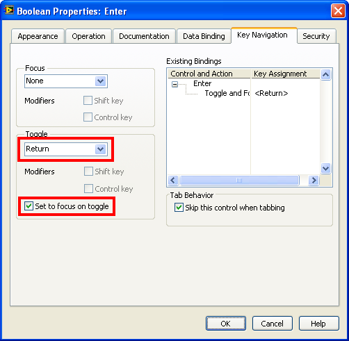

3. On the Key Navigation tab we wll select Return in the Toggle dropdown. NOTE be sure to check the "Set to focus on Toggle" If you do not the enter event will trigger but because the cursor will still be in the password box the value will not update.
