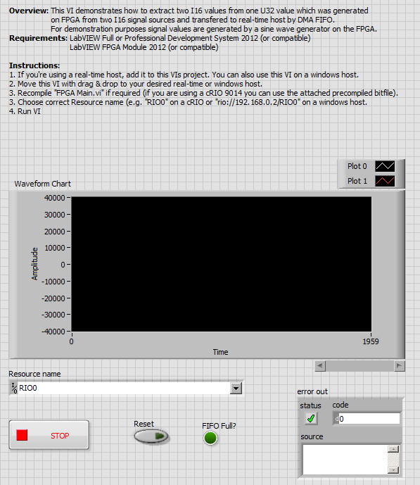

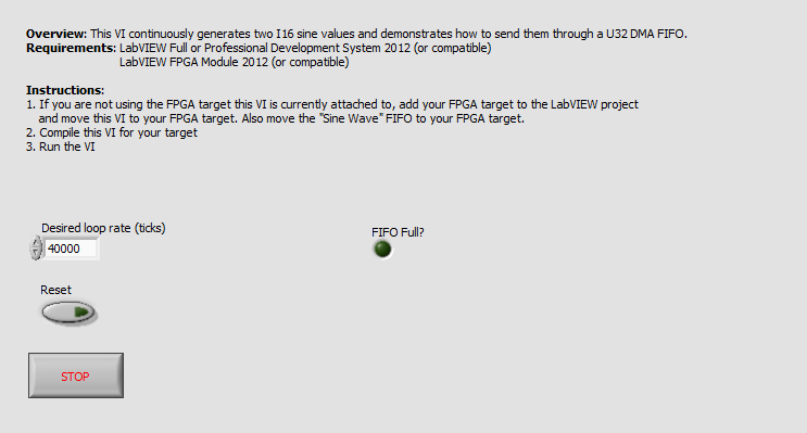

This example demonstrates how to combine two I16 values to send them most efficiently from target to host using a DMA FIFO with U32 datatype. For demonstration purposes signal values are generated by a sine wave generator on the FPGA.
Description
In earlier versions of LabVIEW, the FPGA FIFO is fixed at a U32 Datatype. Since LabVIEW 8.6 any standard type can be used, including fixed point (Release Notes).Also in newer LabVIEW versions the DMA FIFO interface between FPGA and DMA buffer is 32-bits wide. Thus it is most efficient to package 16-bit numbers into a single 32-bit value, and then unpack it on the host. When using a U32 FIFO, it can be confusing when your I16 data gets coerced to a U32 and then Read as a U32 on the host, which requires some careful data conversions. This example shows a way to pack two I16 values into a U32 and then to unpack and continuously show the data on a waveform chart.
This example was built for a cRIO 9118, but can be applied to many different FPGA targets.

  1. Download and open the attached file "Pass two I16 through U32 DMA FIFO LV2012 NIVerified.zip"
  2. Follow the instructions in Front Panel of "Host receiver.vi" and "FPGA sender.vi" and run the program
Host receiver:
FPGA sender:
Note: You can modify the chart history length by right clicking on the waveform chart. Also be sure to change the desired loop rate in "Host receiver.vi" to be representative of the rate you are reading on the FPGA. For this example, I was generating data at 1 kHz on my FPGA which has a top level clock of 40 MHz, so I chose 40k ticks as a desired loop rate. If you have another FPGA target, you might have to consider its different top level clock and change ticks for desired loop rate accordingly.
