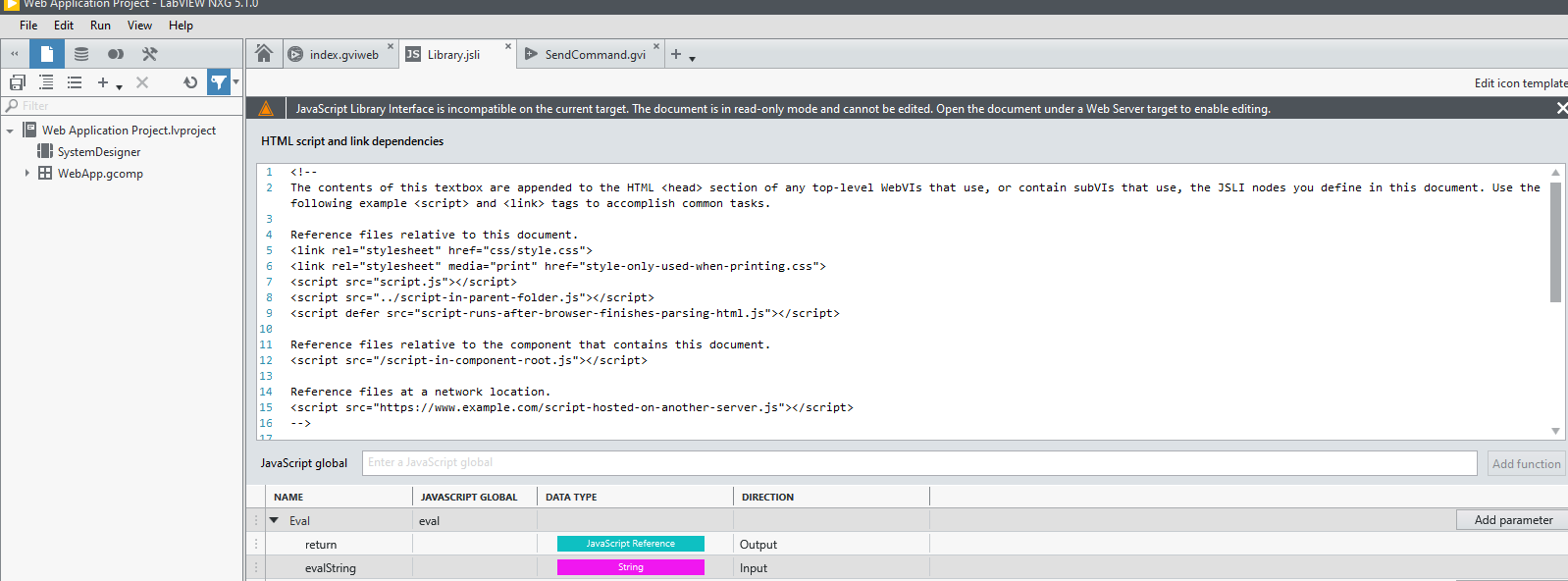

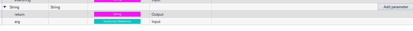

To get access to the resources we need to set up a flexible communication channel to and from the inappbrowser.
Luckily where already covered.
We can send messages to the base application using the postmessage protocol. On which we can add a listener to the inappbrowser in our base application.
We can cover the communication from the base application to the LabVIEW webapplication via the executeScript functionality of the inappbrowser.
To Facilitate this we will need to make some adjustments to the existing Index.js at <application directory>/www/js/index.js:

To be able to send a post message we will need to create a little javascript library in our project:
In this library we will add the Javascript global "eval".
This javascript function allows us to execute strings as javascript code.
This function has a string as input and a javascript Reference as output. (We can cast the outputs using other functions, see example project)
Now to send code we can make a small "SendCommand.gvi" function that allows us to send strings to the base application to be executed:
This function will package the string we want to send into a JSON object and then message it in a postmessage to the base application.
And That's it. We can now access the API through our LabVIEW web application using the above function.

The string function here is a small addition I made to the javascript library and is put beside the eval function.
It reads a javascript reference and translates it to a string.

Now all that is left to do is to read it it in our LabVIEW web module application:
