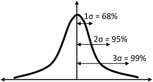

3. Expanded Uncertainty
The final step is calculating the expanded uncertainty. This value is the product of the combined uncertainty and the coverage factor (k😞
Expanded Uncertainty = kσ
The value of k defines the confidence of the measurement. With a normal (Gaussian) distribution, a value k = 2 defines a confidence value of 95%, meaning 95% of measurements fall within ±kσ of the average value.
A value k = 3 defines 99%.
Figure 1
National Instruments uses k = 2 in the NI USB-568x specifications.
