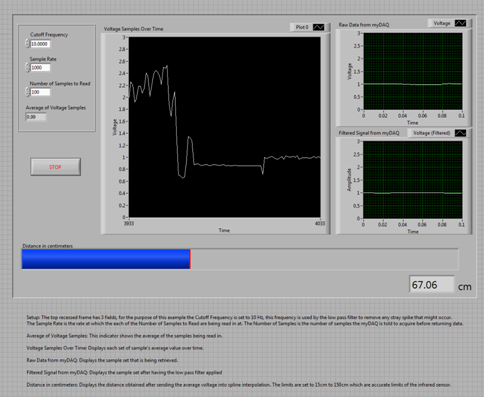

LabVIEW User Interface:
The user interface (see Figure 3) shows the distance in a digital display as well as a progress bar to graphically show the distance. The top left of the front panel we have frequency, sample rate and number of samples as inputs to set the filter and data acquisition tasks. We also have an Average of Voltage samples indicator that will show what the average value for each set of data retrieved from the myDAQ. There are 2 graphs and 1 chart in this example. The chart shows the average voltage and its change over time. The graphs are the raw data coming off the myDAQ and a filtered version of that data. There is also a stop button to stop the VI.
Figure 3: Front Panel of VI
Note: You should avoid using the abort at the top of the VI because this causes the VI to abruptly stop instead of stopping and cleaning up any used references gracefully.

In order to receive data at a consistent rate, use the continuous acquisition mode to get a set amount of data utilizing the myDAQ onboard timing engine. The timing engine will ensure that the time between samples is consistent for the duration of the program.
Even though we have the data, it will be slightly noisy, and this is due to external noise that might be found on the wires or even from extra light being detected by the sensor. Even though the sensor does have signal conditioning to reduce noise, it is not fully immune to noise. In order to filter out the noise, we will use a low pass filter to remove extraneous spikes.
The sensor actually sends back data in "time windows" which can be seen on the graph as “steps” of voltage.  In order to keep the timing and coding simple, we will average the sample set instead of trying to match the timing of the myDAQ's sample set to the sample set of the sensor.
Note: In the data sheet that is attached to this example there is more detailed information on how the samples are sent out through the Vo pin.
