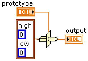

You can represent a 64-bit number by a cluster of two 32-bit numbers. Mathematical operations between 64-bit numbers can be coded using well-known algorithms for arbitrary precision arithmetic. These algorithms are beyond the scope of this paper, but you can easily find them on the web. In addition, these algorithms can also be found in the book The Art of Computer Programming, Volume 2: Seminumerical Algorithms by Donald Knuth.
Now that you have a method to represent and do math on 64-bit numbers, how do you get them to the DLL? The easiest way is to typecast 64-bit entities to doubles, and then pass in a double whenever the DLL asks for a 64-bit integer. Since the typecast does a binary image transform, similar to a union in C, all will be well, provided you have the high and low order double words in the proper order. The graphic at right shows the proper order and the cast to a double. The call library node will take care of byte ordering for the particular platform. This method also works for arrays and will even give the right padding on architectures that require it, such as SPARC. This is because the double is a 64-bit entity. So if the DLL has a function prototype of:
int32 fooFunc(uint64 length, uint64 *elements)
the prototype you create in the call library node looks like
long fooFunc(double length, double *elements).
