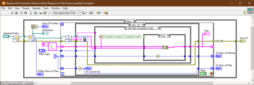

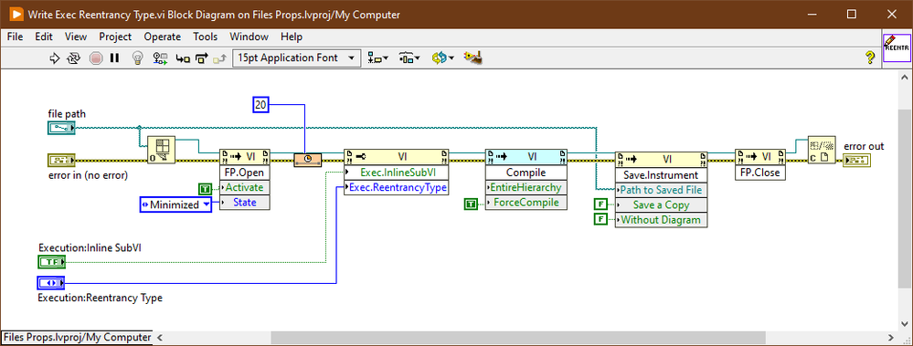

LabVIEW scripting tool for readout and editing file (.vi, .ctl) properties (execution, reentrancy, filename, compiled code, etc). It filters files by selected property.

Readout Filtered Not Sep Compiled Code BD.pngReadout Filtered Not Sep Compiled Code BD.png
