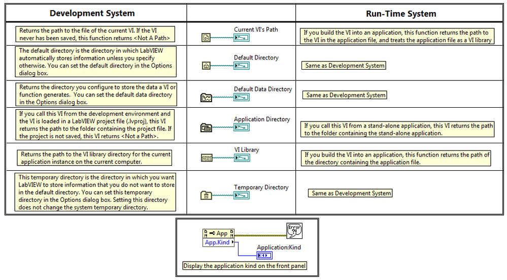

This is a short example to highlight the difference in operation of file path constants between the development and run-time environment in LabVIEW
Description
When performing file operations within a distributed application the developer must take care to ensure that the application is robust to changes in OS, and that all files can be referenced accordingly. There are several file path constants which are used as part of this process.

- Open File Path Example 2012 NIVerified "
- Run Test VI " and view the file paths generated
- Open " Application.exe " from the Executable directory
- Observe the difference in paths generated
VI Block Diagram of "Test VI"
