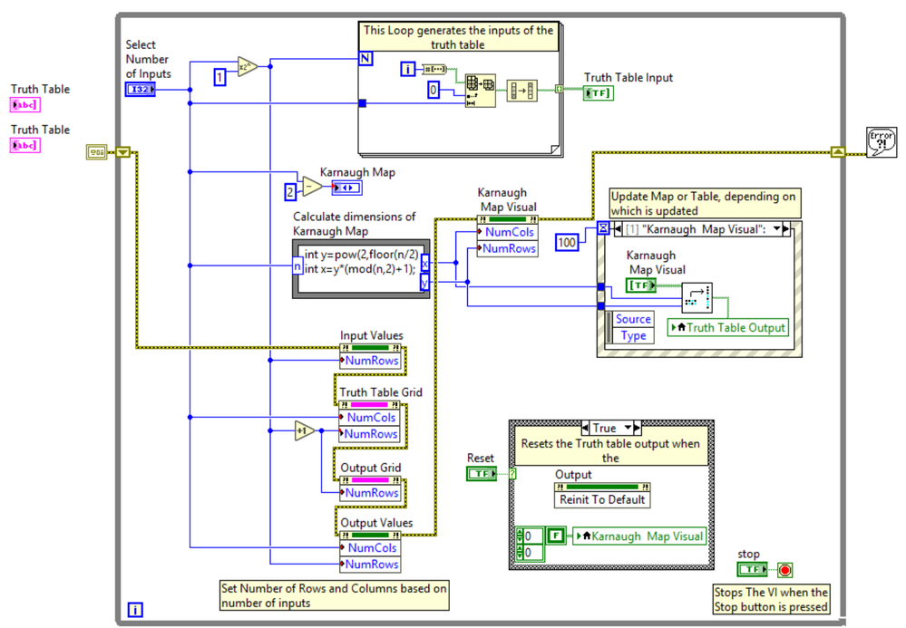

This example allows the user to quickly convert between the karnaugh map and truth table visulaisation
Description
This example allows the user to quickly convert between the karnaugh map and truth table, two common ways of expressing a logical circuit.  The VI can handle 2, 3 or 4 input values.
Requirements
LabVIEW Full Development System 2012 or compatible
  1. Run the VI
  2. Select Number of Inputs (2,3,4)
  3. Change the values on the Karnaugh Map LED buttons or the Output in the truth table and notice how it changes on the other hand
VI Front Panel
VI Block Diagram
