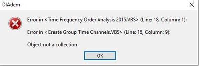

I am running DIAdem 2020 SP1.  I am trying to use the "2015" version of this tool and am getting the following error:
The section of the subscript that is causing the problem seems to be in the object TimeChnRefs not being recognized as a collection.  The workaround I have found is to manually create a time channel in each group that has waveform data, with units of "s"..  After that, the SUD opens and the script runs just fine.  However, it would be nice if the VBS could be corrected to properly create the time channels automatically.  Maybe something in the SCRIPT commands have changed so that this doesn't work the same in 2020 as it did in earlier versions.
