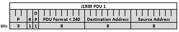

J1939 messages are built on top of CAN 2.0b and make specific use of extended frames.  Extended frames use a 29-bit identifier instead of the common 11-bit identifier.  J1939-21 defines fields within this 29-bit identifier as shown below.
Figure 1. J1939 29-bit Identifier Fields
The first three bits are the priority field.  This field sets the message’s priority on the network and helps ensure messages with higher importance are sent/received before lower priority messages.  Zero is the highest priority.
The next bit is reserved for future use.  This field should be set to zero.
The next bit is the Data Page field.  This is used to expand the maximum number of possible messages.

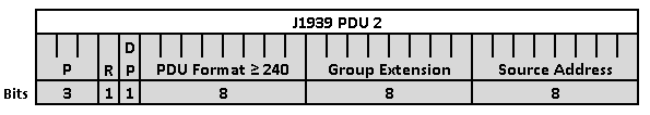

The next eight bits make up the Protocol Data Unit Format (PDU F) field.  This is used to determine if the message is intended for a specific device on the network or if the message is intended for the entire network.  If the value of PDU F is less than 240, the message is meant for a specific device.  If the value is 240 or greater, the message is intended for all devices.
The next eight bits make up the Protocol Data Unit Specific (PDU S) field.  The definition of this field is based on value of the PDU F field.  If PDU F is intended for a specific device (less than 239), PDU S is interpreted as the address of that specific device.  In this case, the PDU S field is referred to as the Destination Address field.  This format is referred to as PDU 1.  If PDU F is intended for all devices (greater than or equal to 240), PDU S is interpreted as a Group Extension field.  This group extension is used to increase the number of possible broadcast messages.  This format is referred to as a PDU 2.
Both formats are described below in picture form.
Figure 2. PDU 1 Format
Figure 3. PDU 2 Format

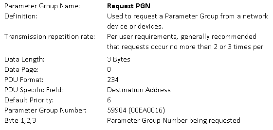

4. Special Messages
Although J1939 uses the PDU F field mainly to specify if the message is PDU 1 or PDU 2, there are a few special values set aside for features like requests, dynamic addressing, and transport protocol.  These values override the greater than/less than rules for PDU 1 and PDU 2 formats.  Requests are used as an example below.
Figure 4. Request PGN
Notice in this example that PDU Format is set to 234.  Normally, this would be handled as a PDU 1.  However, because this is a special message, the device knows to handle the message differently.  In this specific case, it knows it has to respond to the originator of the request in a particular format as defined by the J1939-21 standard.

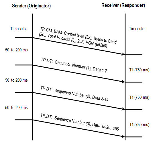

6. BAM Messages
As mentioned above, Broadcast Announcement Messages are intended for the entire network.  Therefore, no handshaking with other devices is required.  The originating device first sends a TP.CM message with a control byte BAM (32).  Next the originator starts sending all the data through the TP.DT messages until all the data has been sent.  Below is an example to show the flow of a BAM message.  Here, PGN 65260 is 20 bytes and is being transferred via BAM in 3 TP.DT packets.

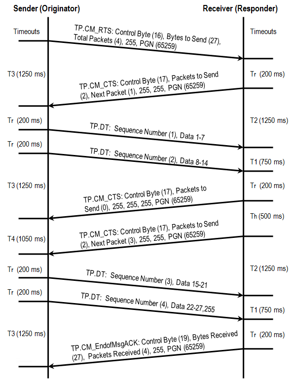

7. Connection Mode Messages
Connection Mode is a peer to peer transfer.  Therefore, handshaking and message acknowledgements are used to guarantee successful data transfer.  First, the originating devices sends a TP.CM message with a control byte Request to Send (16).  This is the originator asking the receiver if it is capable of receiving data.  The receiver can then respond in various ways but normally it is with a TP.CM message containing control byte Clear to Send (17).  The data of the TP.CM Clear to Send message contains the current sequence number to transfer as well as the number of TP.DT packets allowed.  The originator then sends TP.DT messages starting at the sequence requested and stops after reaching the number of TP.DT messages allowed.  This process continues until all the data is transferred.  The receiving device then has to send a TP.CM message with control byte EndofMsgACK (19) confirming that all the data was successfully received.  Here is an example to illustrate a typical Connection Mode message.  Here PGN 65259 is a 27 byte message requiring 4 TP.DT messages.
Figure 6. Connection Mode Data Transfer Example
Note:  It is acceptable to send a TP.CM Clear to Send message indicating that zero packets can be transferred.  This doesn’t mean the connection is invalid.  Instead it means the receiving device isn’t ready for the data.  It is also acceptable to send a TP.CM Clear to Send message with a sequence number that has already been sent.  This is often used when the receiver thinks the previous TP.DT messages were corrupt.

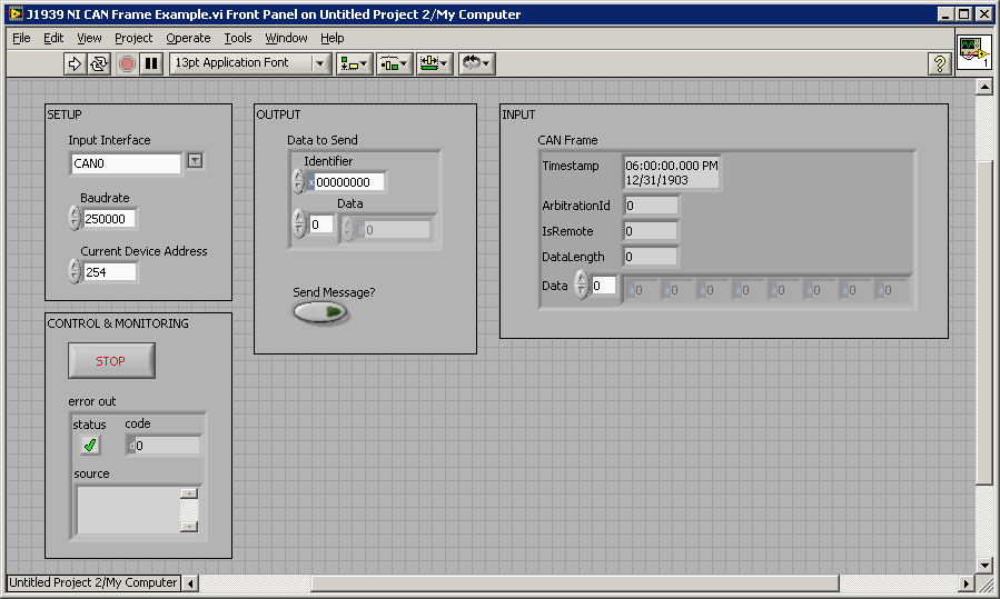

9. NI-CAN Reference Example Front Panel
The front panel of this example contains four sections and is pictured below.
Figure 7. J1939 NI CAN Frame Example Front Panel
The first is labeled Setup.  In this section, the user can select the NI-CAN port, set the baud rate (J1939 is typically 250k) and set the device address.  These setting need to be entered before running the example.
The next section is labeled Control and Monitoring.  This section is used for stopping the VI and viewing any errors that occur.
To the right of these sections is the Output section.  Once the program is running, this section is used to send messages.  The user enters the appropriate information into the Data to Send cluster and selects Send Message?.  The Data array can be more than eight bytes.  If it is, the VI will automatically transfer the message over the network using the correct transport protocol type, abstracting any difference between eight byte (or less) messages and messages greater than eight bytes.  This will be discussed in more detail below.
The last section is labeled Input.  This contains the CAN Frame cluster.  This cluster is where new incoming messages are displayed.  This does not include messages like requests, address claims, and transport protocol messages.  It only includes data messages.  If a data message is greater than eight bytes and is transferred over transport protocol, it will be reconstructed in software (discussed below).  Once this reconstruction occurs, the message will be displayed like any other standard message.

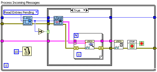

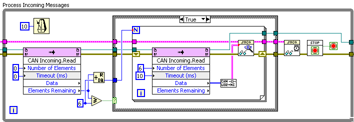

Process Incoming Messages Loop
The first loop is called Process Incoming Messages and is pictured below.
Figure 12. Process Incoming Messages Loop
This loop first checks if there are any messages on the CAN port.  If messages exist, those messages are read and passed to a VI called J1939 Process Incoming Messages.  This VI processes one CAN Frame at a time.  It first filters out any messages that aren't intended for the device.  Then, if the message is intended for the device, it determines the message type.  If the message is a standard PDU 1 or PDU 2 message, it is queued to the second loop (discussed below).
In the case that the message is a transport protocol message, it determines if the message is for a message being generated or received by the device and handles it appropriately.  It also waits until all messages are received and reassembled for a specific PGN before queuing the completed message to the second loop.  The user will never see any of the transport protocol messages, just the finished message.
For other special messages, like requests, address claiming, etc. there are just stubs that don't currently do anything.  These stubs could be implemented such that more J1939 features are available but that will be the responsibility of the user and outside of the scope of this example.

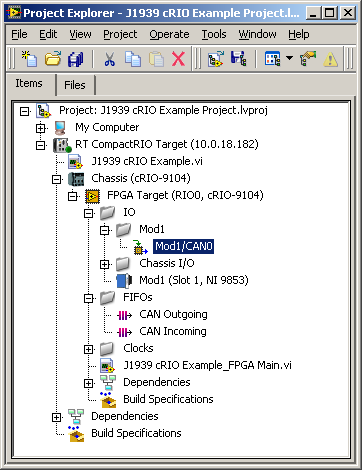

12. cRIO Reference Example Project
The targeting of a CompactRIO requires the use of the LabVIEW Project.  Our project is called J1939 cRIO Example Project and is pictured below.
Figure 15.  J1939 cRIO Example Project
The project contains configuration information about our CompactRIO.  This includes information like IP address, FPGA target type and IO modules.  Note the NI 9853 High Speed CAN module in slot 1 of our FPGA Target.  This is what we are using to read and write our CAN Messages.
Also, notice that there are two VIs in this project.  One is under the RT CompactRIO Target and is called J1939 cRIO Example.vi.  This is our top level VI.  The other VI is under FPGA Target and is called J1939 cRIO Example_FPGA Main.  This VI is responsible for reading and writing CAN messages.  It is started and controlled by our top level VI.
Last, take notice of the two DMA channels named CAN Outgoing and CAN Incoming.  These two channels are used to transfer CAN messages between the cRIO and FPGA programs.

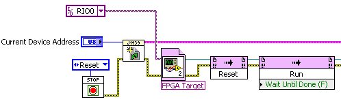

Initialization
The differences in the cRIO example initialization section are hardware specific only.  Instead of initializing our NI-CAN hardware and Frame API, we initialize and start our FPGA VI (J1939 cRIO Example_FPGA Main).  This is pictured below.
Figure 16 J1939 cRIO Example Initialization

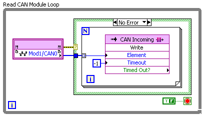

FPGA Code
When we read a CAN message on CompactRIO, we actually need to start with the FPGA code.  The FPGA VI contains a second loop called Read CAN Module Loop and it is pictured below.
Figure 19. Read CAN Module Loop
In this loop, we check for any new messages.  If none are available, we timeout and do nothing.  If messages are available, we send the data into the DMA FIFO named CAN Incoming.  This sends the message up to the host.

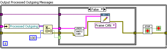

Output Processed Outgoing Messages Loop
In this loop, we convert the frames from the J1939 format to the NI-XNET frame format and write them to the bus.
Figure 23. NI-XNET Output Processed Outgoing Messages Loop
