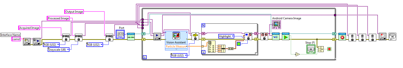

The processing step is largely arbitrary. We perform the following steps:
  1. Extra the Intensity Color Plane
  2. Perform an Edge Detection Filter
  3. Threshold
  4. Particle Filter
  5. Particle Analysis
  6. Overlay Bounding Boxes
  7. Merge Overlay (so our external device can see it)

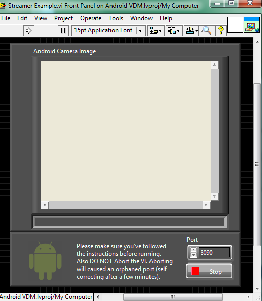

MJPEG Server
The code here is very simple and leverages the previous referenced example code. The C# solution (VS2010) is included in case bugs are found or modifications should be made. The VI package includes the following functions:
  • Dispose MJPEG Server - Closes the server
  • Init MJPEG Server - Starts the server on the designated port
  • Is MJPEG Server Running - Checks to see if the server is running
  • Send Image to MJPEG Server - Sends an image to the server for broadcasting
Additionally two utility functions are included:
  • IMAQ Image To NET Bitmap - Converts an IMAQ Image to a .NET Bitmap
  • Working Bitmap FGV - A functional global variable maintaining the previous Bitmap references for disposal
The example code shows how all of this fits together, but it follows the typical Open, Act, Close paradigm.
Reading From Android
The MJPEG Viewer application we installed at the beginning is now going to come in handy! I have had problems with using the function natively so I recommend opening the URL in the browser and then selecting the app. You will then see your post processed image. This has also been tested in Google Chrome (although it is just a still frame then), and in VLC Media Player. You can open simultaneous connections on multiple devices but it will likely reduce performance unless your host is very capable.
