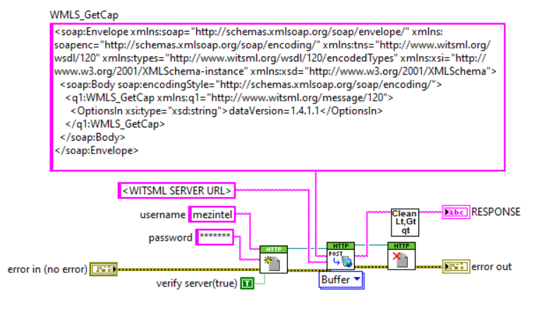

To the rescue: PDS WITSMLstudio Desktop App provides all the SOAP packets to work trouble-free with LabVIEW HTTP VIS for functon calls to a WITSML Server 1.4.1 as follows:

The above comprises all the functions needed to implement WITSML 1.4.1 data streaming for MWD/LWD application using LabVIEW native HTTP client VIs.
Mezintel successfully ran the following LabVIEW HTTP VIs to find that SOAP packets suggested by PDS WITSMLstudio Desktop App all worked on very first try by just copying and pasting the packet to the LabVIEW HTTP POST VI input terminal. See LabVIEW block diagram below.
LabVIEW Implementation by CUTS and PASTE of WMLS_GetCap SOAP packet from PDS WITSMLstudio Desktop Application.

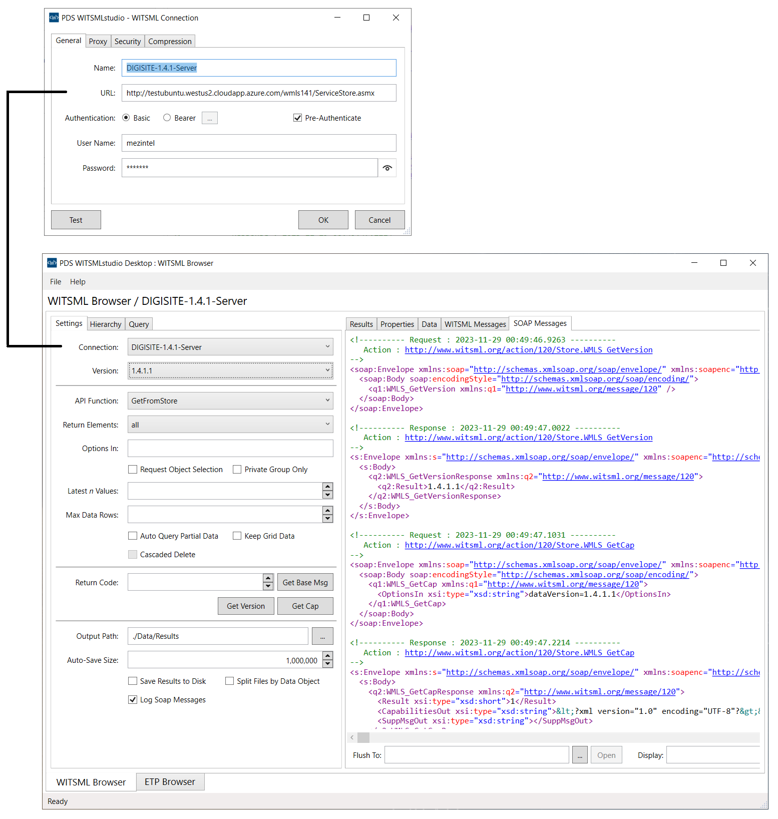

PDS Studio WITSML has all functions for Logging-in, Get Capability, etc.
These screen shots show establishing a connection and how to implement GET-CAP with the associated SOAP data packet that works with LabVIEW via CUT and PASTE.
Select Server connection by visiting the connection setting option.
After getting connected you can call-up the WITSML server capability info by clicking on the <Get Cap> button. Visit the SOAP Messages TAB shown above to get the SOAP packets full envelope that works error free with LabVIEW HHTP POST VIs.
