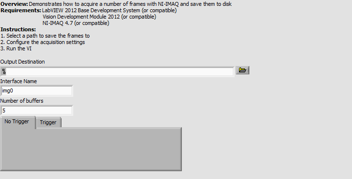

Overview
The example demonstrates how to acquire a number of frames with NI-IMAQ and save them to disk.
Description
This example uses the low level asynchronous acquisition of NI-IMAQ to acquire frames to preallocated buffers.
If activated the acquisition can be triggered so a frame is only acquired when a trigger occurs. The 'IMAQ Occurrence Config' function can generate a occurrence when the acquisition starts or stops, so the application can check whether the asynchronous operation has finished.
Requirements
 Software
  • LabVIEW 2012 Base Development System (or compatible)
  • Vision Development Module 2012 (or compatible)
  • NI-IMAQ 4.7 (or compatible)
 Hardware
  • NI-IMAQ compatible hardware
  1. Select a path to save the frames to
  2. Configure the acquisition settings
  3. Run the VI
