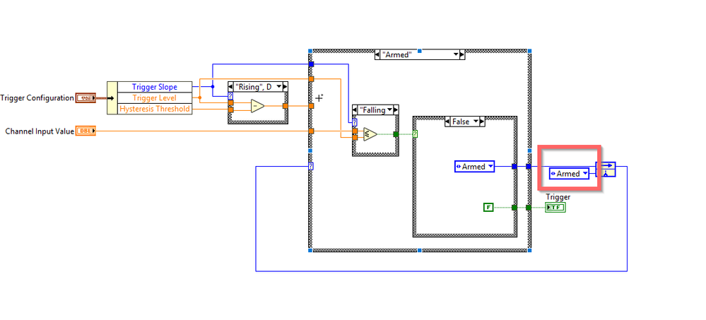

This code demonstrates how to implement a hysteresis trigger in LabVIEW FPGA.
Description
This example uses basic logic functions, simple comparisons and a small state machine to implement a hysteresis trigger in LabVIEW FPGA.
The example implements a two-channel, configurable hysteresis trigger with the option to implement a logic combination trigger (i.e. if trigger 1 and trigger 2 are true, then combo trigger true). The example makes use of the hysteresis trigger IP core which receives the trigger configuration and the channel data, and then outputs a boolean signal if the trigger conditions are true. The example can be easily extended to work with more than two input channels as trigger source.

Great work! Just had to change default state of feedback loop init to Armed so that if initially the input value exceeds the limit it triggers the output
