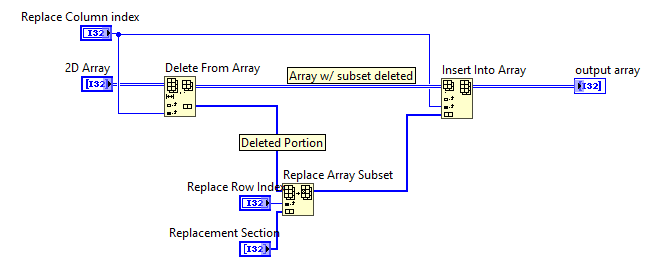

This example replaces a portion of a row or column of a 2D array with a 1D array.
Description
The goal is to replace a portion of a row or column of a 2D array. The Replace Array Subset VI will only replace a single element of a 2D array, so this example shows how to replace a larger section.
Requirements
LabVIEW Base Development System 2012 or compatible
  1. Fill the 2D Array Control
  2. Enter the index of the column and row where the replacement will start
  3. Fill the 1D Array of Replacement Section
VI Block Diagram
