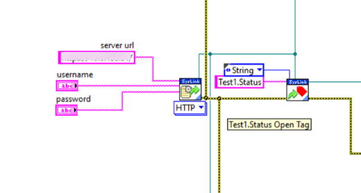

Step 3: Point your Existing LabVIEW Application to the NI Web Server
  • Open your LabVIEW application’s block diagram. In this tutorial, we are referencing the example included on this page, which is using the SystemLink API for the data communication layer.                                                                                                                             photo.jpg
  • Locate the Open Configuration node in the block diagram
    • Make sure the Open Configuration node is set to use the HTTP configuration
    • The required inputs are
      • Server URL: found on the Summary tab of the NI Web Server Configuration menu
      • Username: one of the usernames for the accounts that were configured to access the NI Web Server. This was determined during setup of the NI Web Server in previous steps.
      • Password: the corresponding password for the account and username chosen. This password was chosen during previous steps during setup of the NI Web Server
    • In the example for this tutorial we use string controls for password input.
  • With the correct Server URL and Credentials input into the Open Configuration node, we can now run the VI and see if the SystemLink Tags are being written to correctly on the NI Web Server

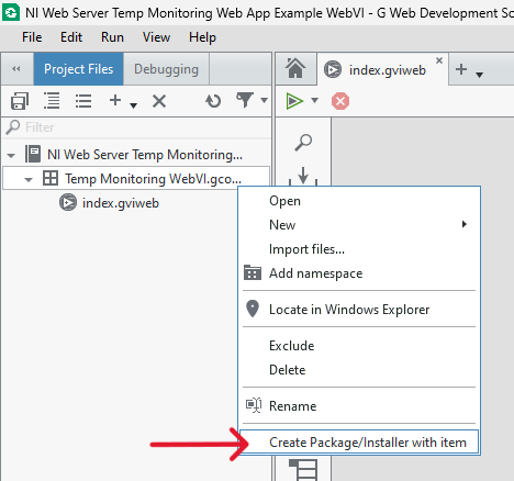

  • The WebVI is now ready to build
    • First, make sure you do not have any credentials saved in your WebVI before building.
    • In the Project pane on the left side of the G Web Development Software development environment, right click the gcomp and select Create Package/installer with item.    Create_Package.png
    • Once the lvdist is open, set the Output Type to Package. This setting can be found in the document pane.
    • In the main editor window, set the Maintainer and Contact email appropriately.
    • Press the hammer icon to start the build.
    • Once the build is complete, select Locate directory in File Explorer in order to see the package built.       Locate_directory.png
