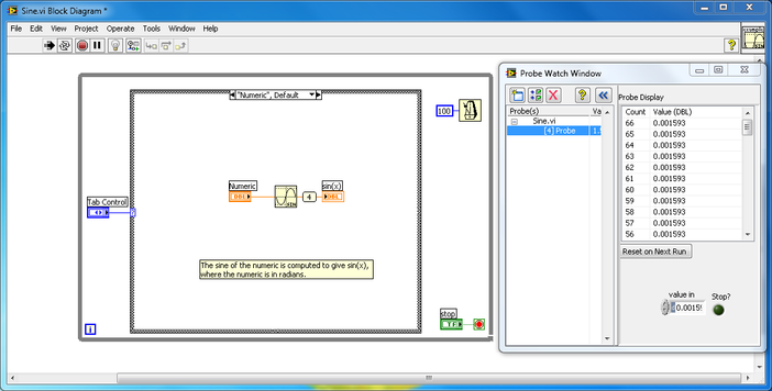

A set of custom probes that display a history of values that have passed through the wire.
Description
These "History Probes" extend the normal functionality of wire probes by displaying a history of the values that have passed through a wire. They support the following scalar
  • Integers:  U8, I8, U16, I16, U32, I32
  • Floating Point:  SGL, DBL, EXT
  • Complex Floating Point:  CSG, CDB, CXT
  • String
  • Path
Each probe includes a "Reset on Next Run" button that allows you to reset the displayed history the next time the custom probe executes, i.e. the next time data flows through the wire.
Requirements
  • LabVIEW 7.0 or later
Follow these instructions to install and use the History Probes:
  1. Unzip the attached file in your LabVIEW Data\Probes folder.  It should create a folder called "History Probes" in that folder.  In Windows, the LabVIEW Data folder is usually located in C:\Documents and Settings\[your username]\My Documents (Windows XP) or C:\Users\[your username]\Documents (Windows 7).  If you are unable to locate this folder, you can instead unzip the "HistoryProbes" folder into your LabVIEW\user.lib\_probes folder
  2. Once the files have been installed, run LabVIEW and open a VI.  Right-click on an appropriate data type wire (see above) and choose "Custom Probe > [type] with History.vi".  For example, if you right-clicked an I32 wire, you would select "Custom Probe > I32 with History.vi"
  3. Run the VI.  As the VI is running, you can view a history of the values that have flowed through that wire during the VI's execution
Note: Each probe indicates the datatype of the wire in its "Value" column header.  Also, each probe's contents can be reset during execution with the "Reset on Next Run" button.  Finally, you can change the display type of integer values to Decimal, Hexadecimal, Octal, or Binary.
Way to select a custom probe in Step 2
Custom Probe Watch Window when VI is running
