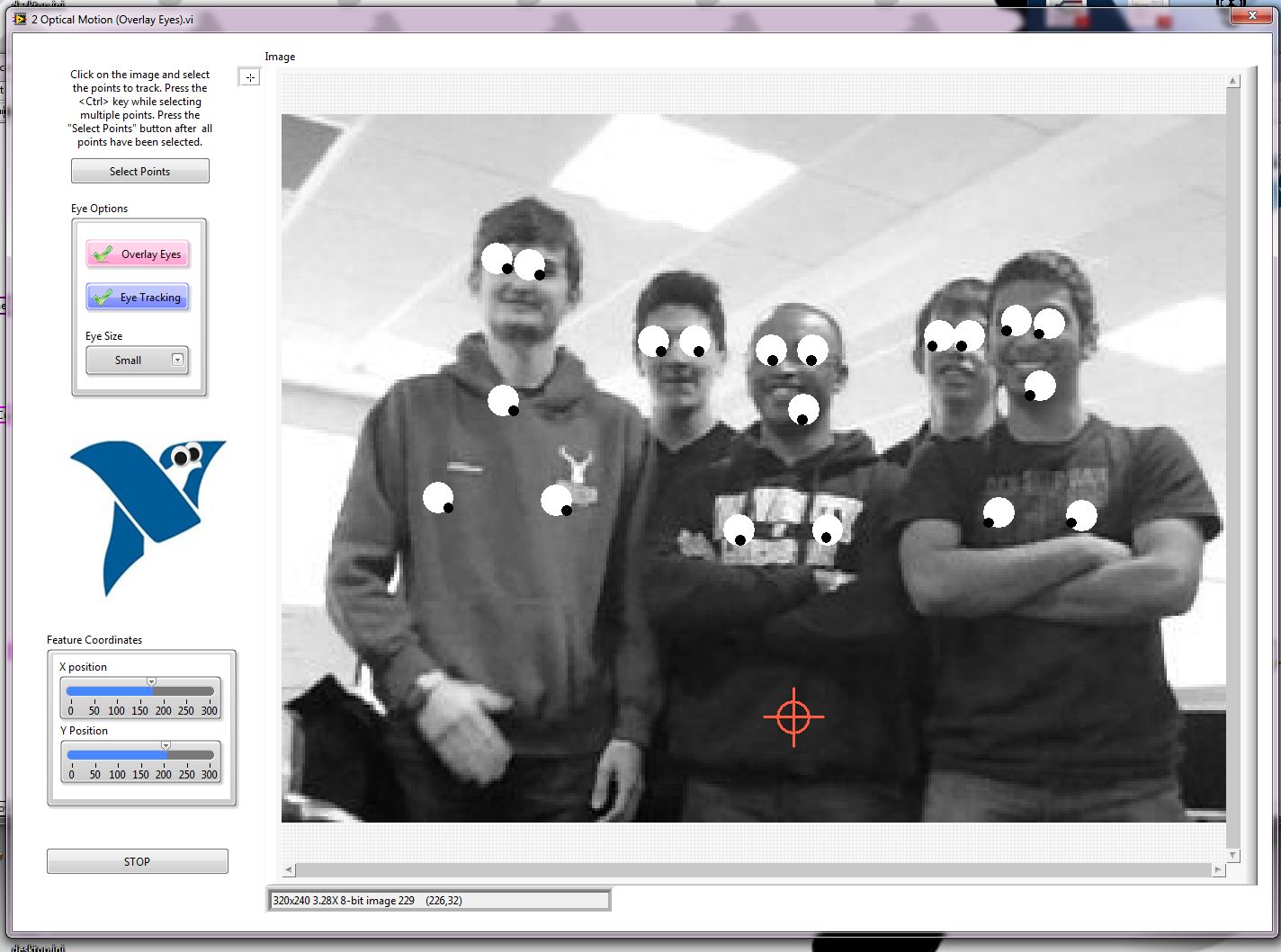

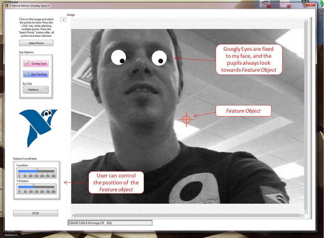

2 Optical Motion (Overlay Eyes).vi
Following the success of the first iteration of the code, I decided to have some fun. This time I implemented features that allow you to add “Googly Eyes” to an object within the image frame. Far from being static, the Googly Eyes will actually stare at a user-controlled feature on the image (identified by a red crosshair).
Here is another image to prove that the object tracking is dynamic! No smoke and mirrors here
Ofcourse, the scalable application architecture means that you can place eyes onto any number of people stood infront of the camera, and the algorithm will happily track the optical flow of multiple points – whilst ensuring that all eyes stare at the feature point!

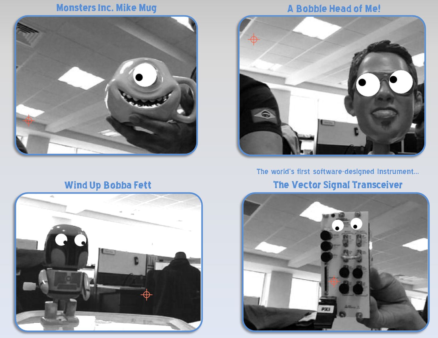

And, it doesn’t just work on humans! The beauty of Googly Eyes is that they can be used to personify anything! Thereby enabling you to add a little charm and personality to just about any object...
