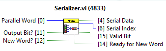

These VIs are meant to help with development of a digital protocol in FPGA. The serializer is useful for the transmit side where an integer input is serialized into bits until ready for the next word. The deserializer works in the receive code by taking input bits and creating an integer output. Both VIs are polymorphic, supported in SCTLs, and support up to 64-bit integers.
Everything was ported to LabVIEW 2009, but comment below is something appears broken.
| Input | Description |
Parallel Word | The integer to be serialized |
| Output Bit? | A handshaking signal to control the ability to output the next bit of the word |
| New Word? | A handshaking signal to signify whether Parallel Word is a new integer. |
| Output | Description |
| Serial Data | The next bit of the word for output |
| Serial Index | A status indicator to show the current bit being output |
| Valid Bit | A handshaking signal to signal downstream logic that the current output bit is valid |
| Ready for New Word | A handshaking signal to signal upstream logic to supply a new integer word |

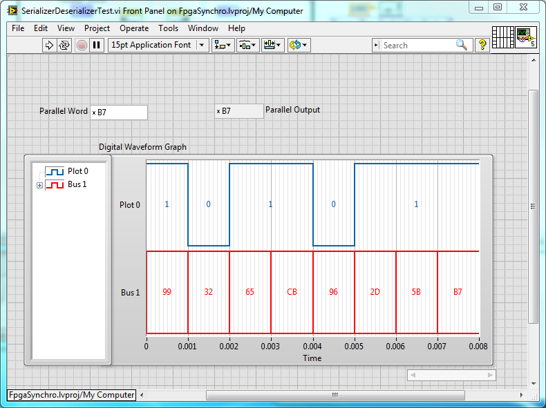

Attached is an example VI (SerializerDeserializerTest.vi) taking the input word, serializing the data, and deserializing the word. The serialization/deserialization is displayed on a digital waveform graph. The handshaking signals would be helpful for streaming applications, where a high throughput must be attained.
Thank you for your VI(s). Is the SerializerDeserializerTest.vi intended to be used as a Host VI? I ask because some of the functions used by SerializerDeserializerTest.vi are not supported by FPGA targets
The serializer/deserializer were meant to be run on FPGA. The Test VI just runs them in a Windows context as a simulation, to use as a full FPGA application would require moving the Serializer/Deserializer to FPGA and DMA FIFOs to transfer data as needed.

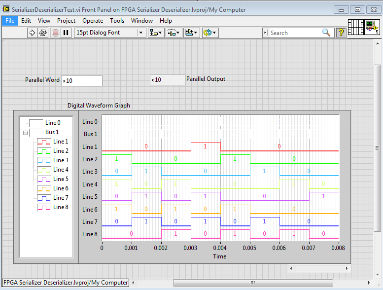

Should I read the Digital Waveform Graph as red/ Line 1 = LSB or b0, pink/ Line 8 = MSB or
b7?
I have attached the graph for x10 and see binary 0001 0000 (b7..b0), reading from bottom to top on right column.
Line 8 would be the MSB. x10 for 8 lines look like "b00010000"
Thank you for the clarification.
