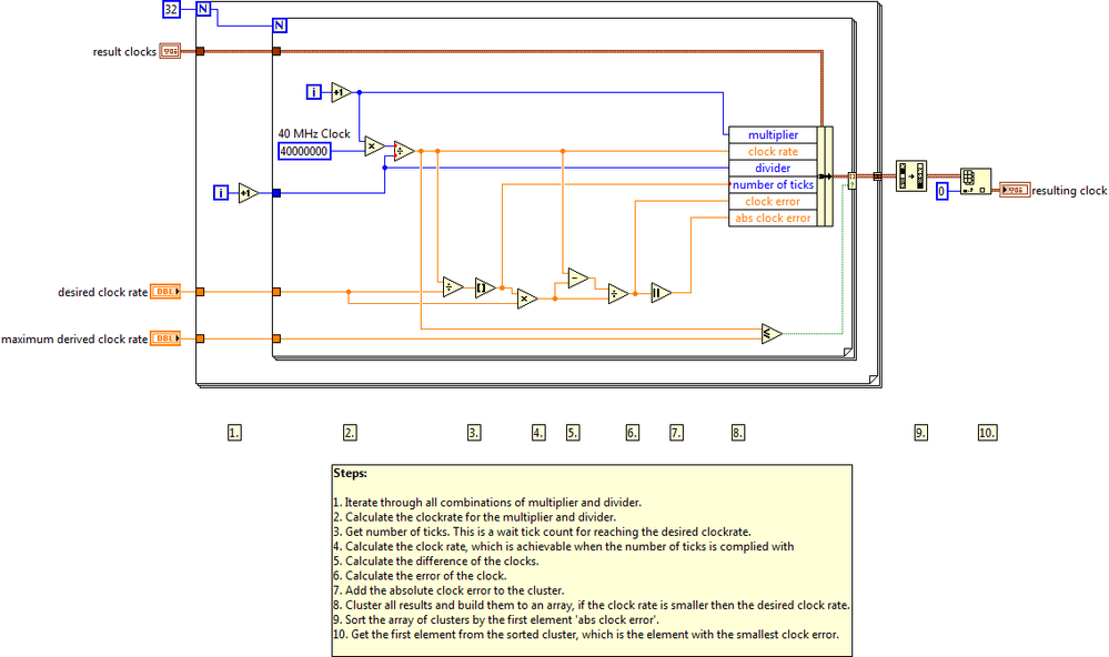

This VI demonstrates how to calculate the derived clock rate and the number of ticks per iteration for a desired clock rate.
Description
 Creating a FPGA derived clock allows to generate custom update rates for applications. If the desired clock rate is below the range of the FPGA derived clock (<2.5 MHz), it is possible to generate a derived clock with a higher frequency. Using a Single Cycle Timed Loop (SCTL) with empty iterations is one possiblity to achieve the desired rate.
One example for achieving the CD sample rate of 44.1 kHz, a derived clock rate of 47.407 MHz (32/27 * 40 MHz) can be used and with executing each 1075th iteration of a SCTL, which gives you 44.0999 kHz. One alternative solution is configuring the "Wait" function and waiting the number of ticks.
The VI calculates all possible FPGA derived clock rates returns the best fitting rate of the derived clock with the number of ticks to wait and the occuring error of the clockrate.

 FPGA Derived Clock Rate Calculator.vi - Block Diagram.pngFPGA Derived Clock Rate Calculator.vi - Block Diagram.png

sockanasa
Member
Member
on
I modified the array that went into the last FOR loop so it didn't just  take the top 20 answers (removed array subset).  Instead, I left them  all and found a combination that works with my Virtex-V.  None of the  first 20 had worked... but #32, a 9/10, ratio did give me something that  could be divided down to 750 kHz.
A more complete program would ask for the FPGA used and weed out derived frequencies that are invalid using Virtex-5 FPGA User Guide (p.58) & Virtex-5 DC and Switching Characteristics Data Sheet (p.57) for the Virtex-V.  See discussion by Donovan B in "derived clock problem? "

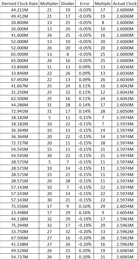

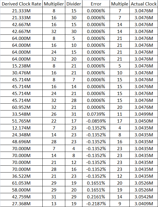

May I obtain the following values obtained from calculator with PXI-785xr?:
2.1296MHz
2.6013MHz
3.0476MHz

Assumed maximum derived clock rate: 80 MHz
Not all options may work, but they are ordered from closest to farthest.
sockanasa
Member
Member
on
2.6006MHz
sockanasa
Member
Member
on
3047600Hz. Same assumptions as above.  Anybody know how to attach csv files to a reply?
