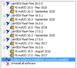

It is important to also install the appropriate drivers on your myRIO. I would recommend that you go to NI MAX and format the myRIO. Then, select the software header and click “Add/Remove Software”
Based on the software that you currently have on your Windows PC, I highly recommend that you select the Software Stack proposed by NI MAX. Select the one that matches the LabVIEW and VeriStand version that you intend to use. Notice that in my case, I could use the “LabVIEW Real-Time 17.0.0” to upload and run a LabVIEW model but I could not make the FPGA I/O work. I had to select “LabVIEW 17.0.2” for both model and I/O to work (see Figure 1).
Figure 1 List of software stacks available to install on a myRIO from NI MAX. The list depends on the applications installed on the Windows PC. Select the one that corresponds to your LabVIEW and VeriStand version.
Once the software stack has been installed, go back to the “Add/Remove Software” and select “Custom software installation (currently installed)”, as shown in Figure 1.
Scroll down to “NI VeriStand Engine XXXX”. Click on it and select the version that you want to install (see Figure 2). NI MAX is going to automatically select other drivers that need to be installed along the engine. Do not change any of those selection. Complete the installation.
Figure 2 Installation of the NI VeriStand Engine. Make sure to select the version matching the version of VeriStand and LabVIEW that you intend to use.
Notice that you cannot run a VI onto the myRIO from LabVIEW and then use the same myRIO with VeriStand. VeriStand is not going to work anymore with the myRIO after running a VI from LabVIEW. You need to use NI MAX to remove the VeriStand engine from the myRIO, and then reinstall it for VeriStand to work with the myRIO again (https://forums.ni.com/t5/NI-VeriStand/VeriStand-error/m-p/2148674#M1939).

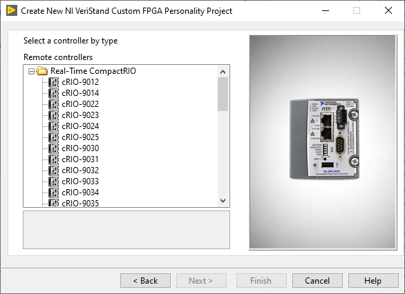

  2. In System Setup, select “Create new system”. There is no setup available for myRIO so discovering existing system is not a viable option.
  1. Select CompactRIO Reconfigurable Embedded System (https://forums.ni.com/t5/Academic-Hardware-Products-myDAQ/myRIO-and-Veristand/m-p/4019294#M7289).
  1. Select a controller, a chassis, and a module.
The trick is to make sure that the Compact RIO driver had been installed. If not, no controller, no chassis, and no module will be available to select. The list of controllers shown in Figure 3 would then be empty.
Figure 3 List of Compact RIO Reconfigurable Embedded System available to create a LabVIEW project template. If the Compact RIO driver had not been installed on the Windows PC, this list would be empty.
To generate the files attached with this document, I selected:
  1. 9022 controller
  2. 9101 chassis
  3. 9381 module (I selected the 9381 because it contains AO, AI, and DIO, like a myRIO).

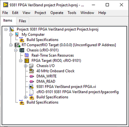

  1. Open the project (see Figure 4).
Figure 4 Project as created from template before any modification to fit a myRIO.

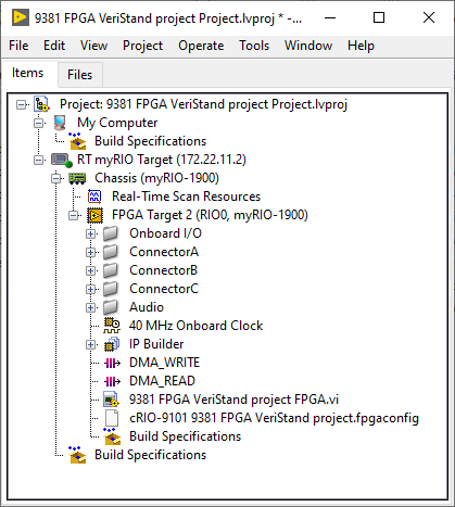

  1. Add a myRIO target. You might have to enter the IP address your myRIO.
  2. Move the “9381 FPGA VeriStand project FPGA.vi”, “cRIO-9101 9381 FPGA VeriStand project.fpgaconfig”, DMA_WRITE, and DMA_READ items from “FPGA Target (RIO0, cRIO-9101)” to “FPGA Target 2 (RIO0, myRIO-1900)”.
  3. Remove “RT CompactRIO Target (0.0.0.0) from project. Your project should then look like Figure 5.
Figure 5 LabVIEW project after adding myRIO target, moving the FPGA VI, FPGA configuration file, DMA_WRITE and DMA_READ; and removing the Compact RIO target from the project.

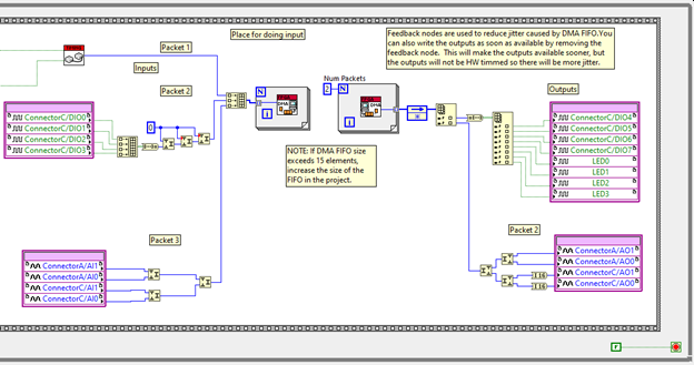

The communication between VeriStand and the FPGA board is done through DMA. I/O Data are interleaved. Data is transferred through the DMA FIFO by packets. The data type of the packet is configurable. In the present case, it is set to U64.
For communication from the FPGA board to VeriStand, a U64 array is wired to a For Loop that contains the “NI VeriStand – Send Packet to Host.vi”. Each element of that array contains some of the data. The first element is required for timing and should be left as-is. The second element contains the digital inputs from the FPGA board. In my case, I wanted to change the number of DIO outputs. So I deleted the subVI “4 Ch Digital Input.vi” and the cluster of I/O reference wired to it. I added a I/O FPGA node. I selected “ConnectorC/DIO0” and configured it for Read. I added 3 more nodes by dragging the bottom of the I/O node to get the ConnectorC/DIO 1 to 3. Each output of the node is a bit. Building an array of Booleans from those outputs and using the “Boolean Array to Number” function, I get a U8 number of which the first four bits represent the values of those four digital inputs. The U8 number is then combined into a U16 with a value of 0, the resulting U32 is then combined with a value of 0 to form a U64. That is the second packet. Notice that this packet of 64 bits contain only 4 bits of useful information. More digital inputs could easily be added. Also notice that the number containing the useful information is always added to the lo input of the “Join Numbers” function. The result is that the four bits are the first four bits of the U64 packet. Also notice that the code to convert the digital inputs into a U64 can be copied from the subVI “4 Ch Digital Input.vi”.
A similar approach is used for the Analog inputs. The cluster and subVI are deleted and a FPGA I/O node is added. The ConnectorA/AI0 and AI1, and ConnectorC/AI0 and AI1 are added. Each output of the node is 16 bit (the AI on myRIO is 12-bit but coded on 16-bit, the last 4 bits are not used). Combining the four outputs together requires 64 bits which makes the third packet. Notice that as for the DIO, the lo inputs of the “Join Numbers” function correspond to the lower bits of the U64. It means the analog input data will arrive to VeriStand in the order from bottom to top. This is important when modifying the FPGA configuration file.
Data is sent from the FPGA board to VeriStand, one U64 packet at a time using the subVI “NI VeriStand – Sent Packet to Host.vi”. Data is received one U64 packet at a time by the FPGA board from the Host by the “NI VeriStand – Receive Packet from Host.vi”.
The For Loop should be configured to run for the expected number of packets. The output of the For Loop is an array of U64, each element representing a packet. In the present case, the first packet is used for the digital data. I deleted the cluster and the subVI and I added a FPGA I/O node configured for 8 digital outputs (configured for Write). The first packet is converted into an array of Booleans and the first 8 elements are wired to the 8 digital outputs of the I/O node.
The second U64 packet is broken down in four 16-bit values that are written to a I/O node containing ConnectorC/AO 0 and 1, and ConnectorA/AO 0 and 1. Notice that the U16 values are explicitly converted to I16 for ConnectorC/AOs to avoid coercion dots because those AOs can output +/- 10V and would therefore accept negative values. ConnectorA AOs only output 0 to 5 V.
The resulting FPGA VI block diagram is shown in Figure 8.
Figure 8 Final block diagram of the FPGA VI after modifications.
