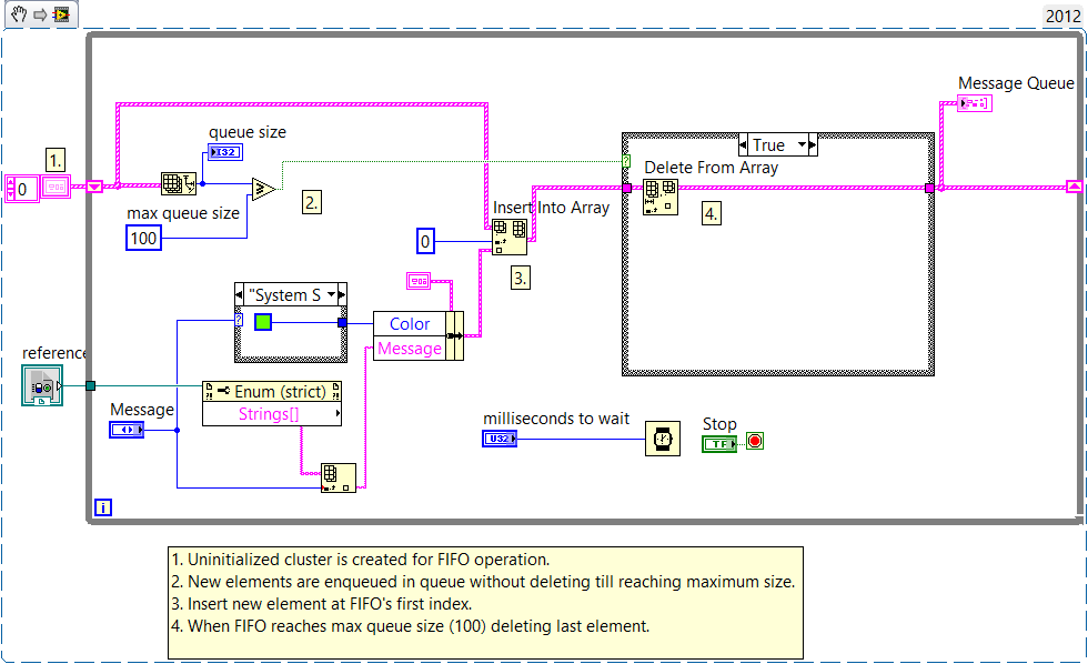

This VI implements a color-coded FIFO (First In First Out) Message Queue using array functions.
Description
The queue is actually an array of clusters. Each cluster contains a color box indicator and a string containing user-defined information.The queue is populated until it reaches a user-specified maximum queue size, and then acts as a FIFO after that (an element is added at the beginning of the array, and deleted from the end).This example could be used to return specific messages to the user over the course of a test based on specific input conditions.Integration of an event structure to add a message to the queue only upon specific event occurrences would also increase the usefulness of this code in certain situations.
Requirements
Software:
  • LabVIEW 2012 (or compatible)
1. Run the VI.
2. Adjust "message" and follow the "Message Queue" indicator.
3. Adjust the "milliseconds to wait" control to control execution speed.
