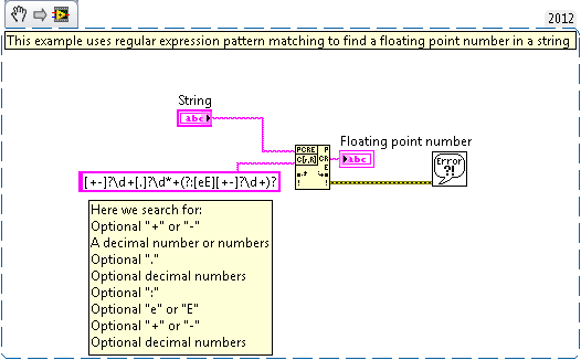

This example demonstrates how to match the floating point with a string.
Description
This example shows the use of a regular expression to match any floating point (DBL) number that is being transmitted as a string.
Requirements
  • LabVIEW 2012 (or compatible)
  1. Download the attached folder to your computer
  2. Open the VI "Regex 2012 NIVerified.vi"
  3. Run the VI
VI Sinppet
