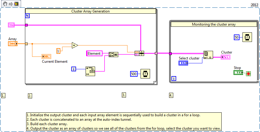

This code shows the basic manipulation of an array to be placed into a cluster, then set back into an array.
Description
This code was developed for use in an application that needed a descriptive string associated with each element of data. This is useful if a developer has an existing array and they'd like to place the data side by side with some sort of descriptive string.

  1. Configure an input array (random in the case of this example)
  2. Click run
  3. Observe the different elements in the cluster, and the add operation that took place
