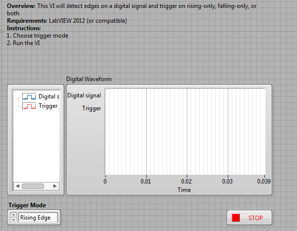

Overview
This VI will detect edges on a digital signal and trigger on rising-only, falling-only, or both.  Can be used inside a single-cycle timed-loop.
Description
This VI uses an array of Boolean to simulate a digital signal. The program uses two Sub-VI's: Simple Edge Detection.vi and Digital Waveform Chart Maker.vi. The Simple Edge Detection Sub-VI detects rising, falling, or rising and falling edges. The edge detection works based on simple logic functions. For rising edge detection, if the current Boolean value is true AND the inverse of the previous value is true, then there is an edge. For falling edge detection, if the current Boolean value is false AND the inverse of the previous value is false, then there is an edge. To detect both rising and falling edges, a XOR function is used: if one and only one of the current or previous Boolean values is true and the other false, then there is an edge. The Digital Waveform Chart Maker.vi transposes the array of Boolean and displays the data on a chart.
1.     Unzip the Simple Edge Detection.zip folder.
2.     Open Simple Edge Detection Example.vi.
3.     Choose the mode: Rising Edge, Falling Edge, or Both
4.     Run the VI.

Front Panel:
