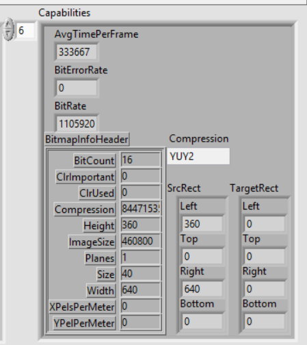

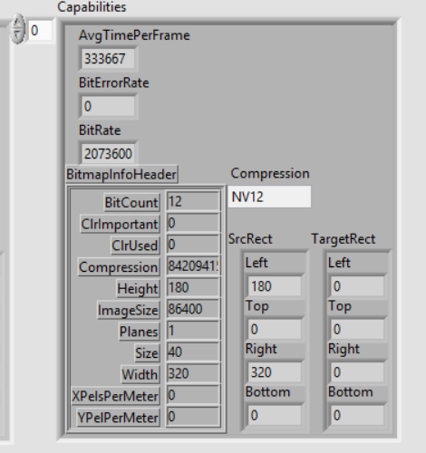

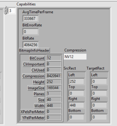

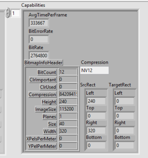

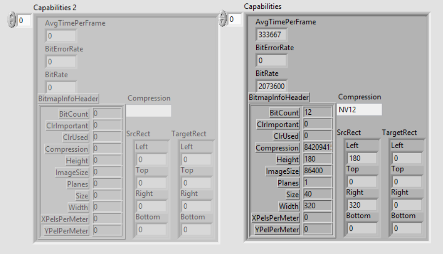

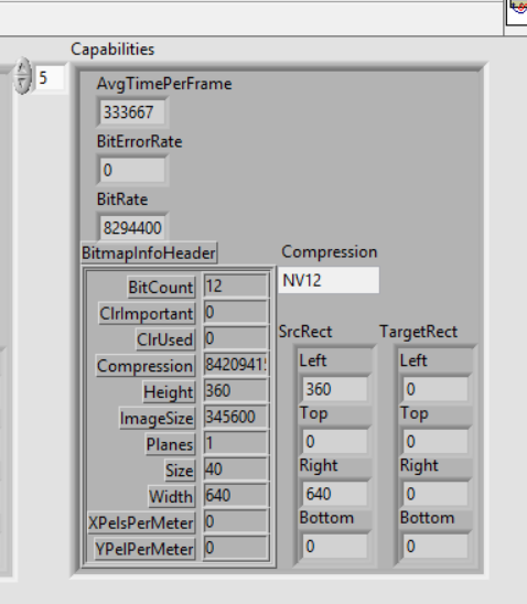

I find that the library is a great job.

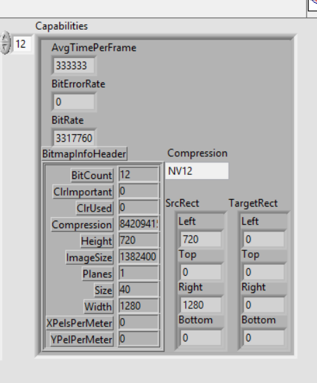

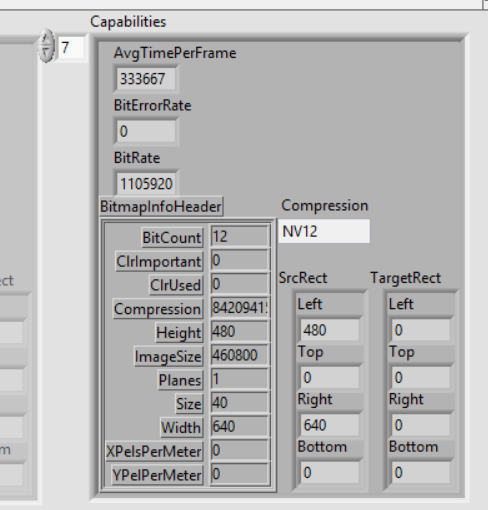

Iam pretty new. I'm trying to use the example "DirectShow - Example - Sample Acquire Video plus Grabber.vi". On the computer with a USB webcam (logitech C270, Windows 10 and LabView 2014) it works properly. But I try to run on a tablet with Windows 10 (https://www.pccomponentes.com/energy-system-energy-tablet-8---windows-lego-edition) and I can see the image of the front camera, but it does not grab me (I get a picture in black, attached capture).
I noticed that the cameras of the tablet have a NV12 format camera and computer has a RGB format. In the case of I only need to transform from one to another, what would you add and where?
P.S .: If I connect the webcam on the tablet, it also works
Thanks in advanvance.

Hi, Thank you.
I think colorspace filter in front of samplegrabber filter would do the job, but would be nice to check with GraphEdit program but you are on win10 tablet... Good luck
I will be back in ofiice on Friday and check if i can re-produce your case on my PC.

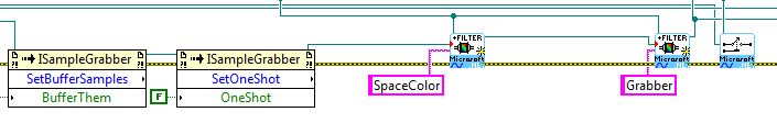

My main problem is that I do not know how the library works and although I tried to find information, I still do not learn anything. I do not know how to connect terminals (if it had worked, it would have been lucky only).
I created a filter just before the filter "Grabber". But nothing changes. Surely it is not well done .
(I attached a screenshot of where I put the filter)

Quick testing not so promising at the moment, but while it is possible to go from NV12 to RGB (with performance hit, re-order bit array before passing it to bitmap), but what other formats available on your Windows 10 tablet, should be others like I420, RGB24, BGR...
-Artur
alvaroaldama92
Member
Member
on
Hello, I was trying to check the availables formats on the tablet, but I do not how to do that. It can be made with the program that you mention or at the windows configuration?
alvaroaldama92
Member
Member
on

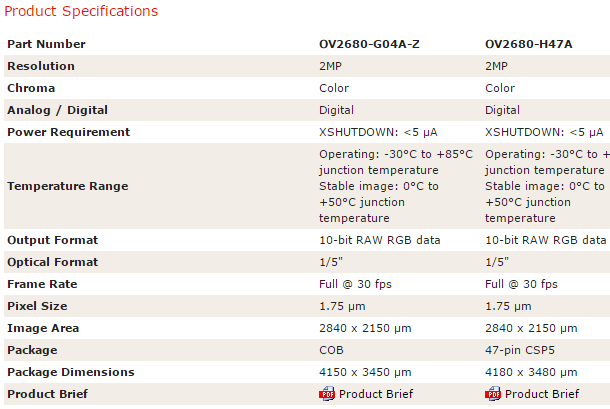

I am checking the camera sensor and it is an Unicam ov2680.
Checking at the Internet the valid formats, it said that the supported valid format is RAW 10-bit RGB
How is that posible?
GriffinRU
Member
Member
on
alvaroaldama92
Member
Member
on
I could not find the "enum filters" vi so I creted this similar vi:
And the results that I get :
GriffinRU
Member
Member
on

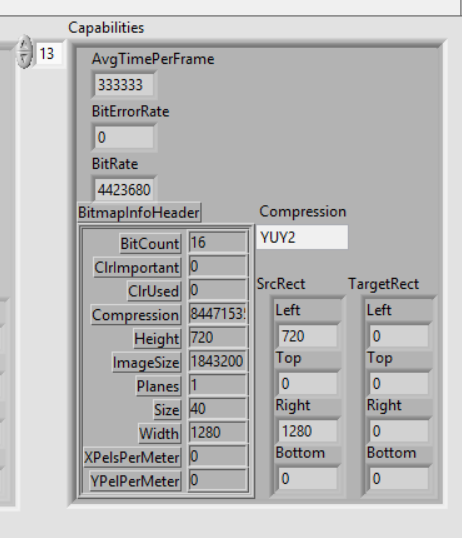

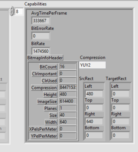

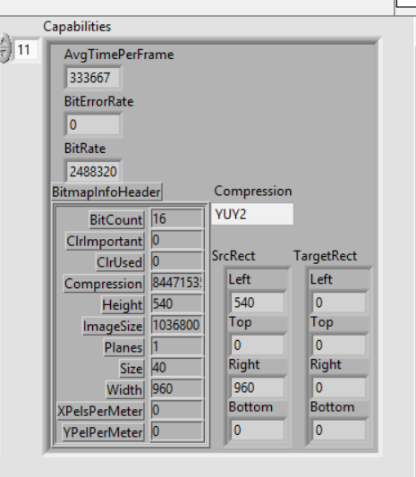

Can you share the array contents? Compression types...
-Artur
alvaroaldama92
Member
Member
on
Sorry for not answering until today, but I have been a little busy.
GriffinRU
Member
Member
on
No problem,
Looks strange that you do not have 720x1280 in YUY2 format, but try to use that format and report back.
-Artur

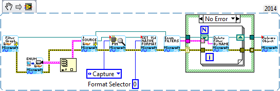

P.S. You can select format in similar fashion or check how I've done it in top level vi under "Video" case.
alvaroaldama92
Member
Member
on
Sorry but I am trying to find where I have to select the format, but I do not know where.
GriffinRU
Member
Member
on
alvaroaldama92
Member
Member
on
Thank you very much for all the help, finally works.
Without your help it would not have been possible.
A greeting

If you can get the frame properly with framegrabber than it is something wrong with videorenderer filter.
If you cannot get frame - try to add colorspace filter and try again, given that should be tried first with graphpgedit and then in labview.
If problem with videorenderer filter - you can try other renderer filters.
If it is not clear - let me know i will try to build labview code...
- Artur
