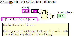

This example checks if the string is just a number
2. Description:
This example will get an string and perform several analysis over to determine if it is a number or if it contains any character. If it is a number, the LED in the front panel will be set to true.

Or, you could do this:
Or:

add a plus sign or a minus sign:
(^[+-]+[\d]+\.?[\d]*$)|(^[\d]+\.?[\d]*$)|(^\.[\d]+$)

I probably would use lexical class for the original problem.
