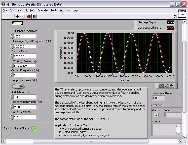

This example demonstrates generation and demodulation of a simulated double side band (DSB) AM signal. You control the number of samples, message signal frequency (Hz), duration (sec), and the type of waveform used for the message signal. You can also control the carrier phase (rad) and the amplitude of the added white noise. The example assumes that the generated information signal is normalized to be between +1.0 and -1.0. The demodulated AM message signal is displayed on the AM Demodulated Signal graph. This program is a shipping example VI included with the Modulation Toolkit for NI LabVIEW.

Front Panel
This is a picture of the VI's front panel. To view the block diagram and additional documentation, download the attached file.
