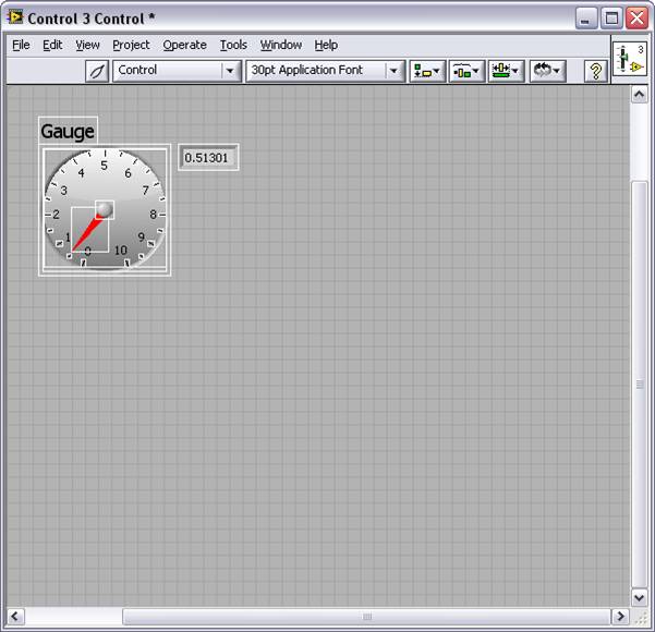

  1. Start by adding a gauge to your front panel, then select it and copy it to the clipboard. We will come back to it after creating a new background image to replace the plain white background the gauge currently has.
2. There are numerous elements of the gauge control which we can edit. The needle is the notable exception (although you can change its color). There is an advantage to leaving the default frame as it is a vector graphic which scales very nicely. Scaling effects are most visible around the edge of your control so leaving the default frame while customizing the background image and the center piece is a good compromise between scalability and customizability. In this example we will replace the background and center piece.
3.       Now you have your background image created it’s time to switch back to LabVIEW. Right click on your gauge and select Advanced»Customize to bring up the control editor.
4.       Change to Customize Mode by clicking on the wrench icon on the toolbar
5.       Customize mode allows you to move, rescale or replace any of the stock components of a control.  In order to use your new background image, right click on the current dial and select Import from File at Same Size….
6.       Browse to select your new background image.
7.       You background will take the place of the original plain background.
8.       The center piece of the gauge is also replaceable using the same technique.  For this example right click and select Import from File at Same Size… and use the same background image.  You will end up with something like this:
9.     Save your new control by selecting File»Save.
10.   Now when you close the control editor LabVIEW will prompt you if you want to replace the original control.  Click “Yes”.
11.   Congratulations you have created a nice looking, reusable gauge.  As we created a large background image and kept the original frame your gauge will rescale nicely up to, and probably a little beyond, the size of the original background image size.
12.   This is a quick and easy example of what is possible.  Using the control editor you can create almost any style of gauge you’d like, here are few of my favorites:
13.   In addition to using custom created graphics, using real-life images such as photographs can lend provide a familiar interface to users who are not familiar with virtual instruments.  In this last sample you can see how a photo can be used as the basis of a custom control:
