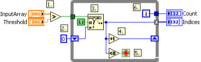

what if you wanted to know the position of the elements inside the array that were above threshold?
Chris.Osiecki
Member
Member
on
You would have to scan for values at that point. Here's how I would do it:
1. Threshold your array
2. Set your starting index
3. Search for a TRUE (TRUE values will be where InputArray was greater than your threshold)
4. Add 1 to the found index and use that for the starting index for your next search.
5. If the search finds no more TRUEs, it will return -1. If the return is < 0, stop the search.
6. Use the last iteration counter value to give you a count of elements found.
Auto-indexing of the found TRUE indices will produce an array that contains the index of all values in InputArray above your threshold.
Note: This method will always have a -1 as the last value of the output array. However, since the iteration counter starts at 0, the Count will be correct without the need for adjustment.
