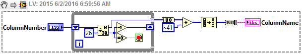

27 gives AA which is correct, but 28 gives BB which is incorrect as the next column in excel is AB

You can design a quite simple VI working from A to ZZZ (which makes some 18928 rows) based on the indexing of an array containing an empty string and the 26 letters ! See the snippet attached for example !
Mine goes 0=A, 1=B,... 25=Z, 26=AA, 27=AB,... 701=ZZ, 702=AAA, etc... but you can make your own based on your needs !
I use it for Excel ActiveX in Labview, quite useful
Found a bug in your code.  1377 is AZZ, but then 1378 is AZA (should be BAA).  From there, you are off by 26.
Here is a more generic version (does not care how many letters it takes)

My bad, I had no use of so many columns so I did not test these values !
Thank you for your answer ! Maybe this post should be edited to mention your code or at least not refer to Excel column names ?
