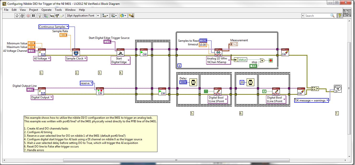

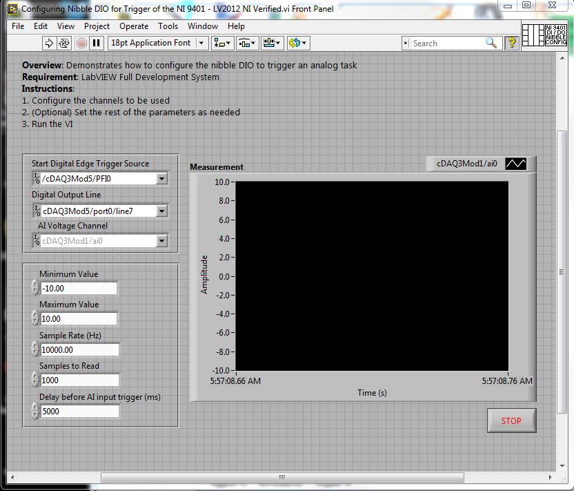

The example will shows how to utilize the nibble DI/O configuration on the 9401 to trigger an analog task.
Description:
The VI would walks you  through the instance of utilizing the nible DIO of the 9401. Using the DAQmx functions and trigger, it would then wait a user selected delay and eventually would start the AI acquisition and finish by resetting the DO line to False after the trigger occurs
Steps to implement or execute code
To implement this example:
  1. Configure the channels
  2. (Optional) Specify the rest of the parameters as needed
  3. Run the VI
  4. (Optional) Turn on the Highlight Execution to see the flow of the VI
