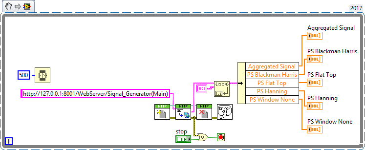

This program shows an example of a LabVIEW Web Client communicating to a LabVIEW Web Server to get updates using the GET method.
Description
A web client can exchange data with a remote LabVIEW stand-alone application over a network through LabVIEW Web services for multiple reasons:
  1. Users can invoke the Web service VIs with any HTTP-capable web client, including a standard web browser, to exchange data using a URL and standard HTTP methods such as POST and GET.
  2. Users can remotely monitor and control embedded applications using custom thin clients.
  3. You can conduct application-to-application data exchange between numerous HTTP-capable devices and software from both National Instruments and third parties.
In this example we will be using the GET Method to read a dual tone signal with varying frequency and their spectral analysis with multiple windowing techniques from teh Web Server.
The WebServer generates 2 tones with sliding frequency and calculates the spectrum after applying multiple windows. for more information refer to the Signal Generation subVI. The output is then flattened into a Jason String that is written by the server as a response stream. The client Client(Main).vi communicates with this method with its URL (the URL used is on the debugging port to run this example in the development environment) using the HTTP VIs. The received data is then unflattened from Jason to view the cluster of data as sent.

To execute this example, follow the below instructions:
  1. Open the project LV_WebServer.lvproj
  2. Expand the Webserver virtual folder, right click on WebServer and click on Publish, then click on Start
  3. Expand the Client virtual Folder, Open and run the Client(Main).vi
  4. Stop Execution
  5. Stop the WebServer
  6. To view the Method URL used in the code, right click on Signal_Generator(Main).vi(GET) method under Webserver>>Web resources and click on Show Method URL, then ensure you select 8001-Local Debugging from Available Servers.

The Client Front Panel would look like this:Client.JPG
And below are the VI Snippets of the Client VI, the Web-server Main and SubVIs respectively:
Client:Client Block Diagram.png
