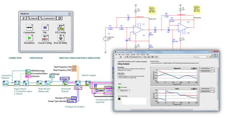

The NI LabVIEW Multisim API Toolkit has been developed for the LabVIEW environment and provides access to more than 120 functions to automate the simulation of a Multisim circuit from LabVIEW. This toolkit is an innovative new connection between the worlds of design and graphical programming. You can for automate simulations easily from a graphical programming language, to do a number of tasks. One of the most innovative tasks that can be automated by the LabVIEW Multisim API Toolkit is for an educator to mark student circuit files as correct or incorrect in a rapid manner.
Introduction
Multisim allows educators and engineers to use and simulation to teach fundamental topics to students in analog, digital and power electronics. With the LabVIEW Multisim API toolkit added in Multisim 13.0 educators can also automate simulation in the LabVIEW environment. This means that applications can be developed that can use Multisim as a source of measurement data. LabVIEW can then be used to acquire, analyze, correlate and present simulated measurements in custom interfaces.
In this tutorial we will learn how to use this capability to take multiple circuits (for example circuit homework completed by students) and compare the output to the solution (as defined by the professor). The automated assessment application will then grade the circuits as incorrect or correct based upon this API toolkit.
What is the LabVIEW Multisim API Toolkit?
Multisim natively provides an Application Programming Interface (API) that allows for the automation of circuit simulation and analyses through a COM interface that designers can use to programmatically control.
The LabVIEW Multisim API Toolkit is a collection of VIs that makes the Multisim API ready-to-use for LabVIEW users. With this API toolkit users can take advantage of over 120 ready-to-use LabVIEW Virtual Instruments (VIs) to:

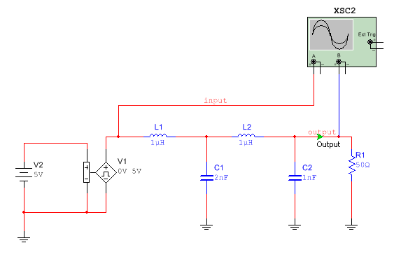

In the following image you can see the professor solution of the circuit.

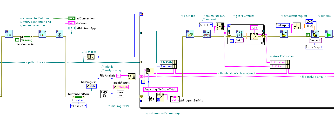

Next you will see the LabVIEW application along with the code that has been developed using the LabVIEW Multisim API Toolkit. Let us begin by seeing the block diagram and then view the user interface after it has been run.
