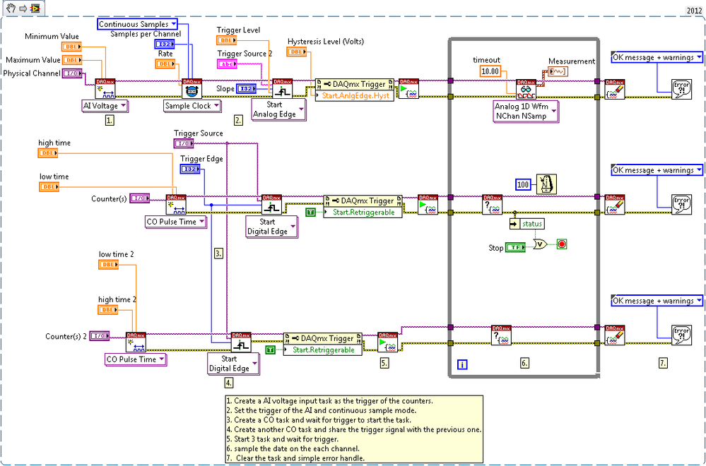

This example can use an analog input to trigger the generation of a digital pulse on two counter outputs simultaneously.
Description
You can use NI-DAQ to acquire or counter multiple channel signal at the same time. This demonstration can be used to use an analog input to trigger the two counter start task at the same time.
Requirements
  • LabVIEW 2012 (or compatible)
  • NI-DAQmx 12.0 (or compatible)
  • Select the device or physical Channels you pick.
  • Set up analog input signal to trigger off.
  • Run the program
