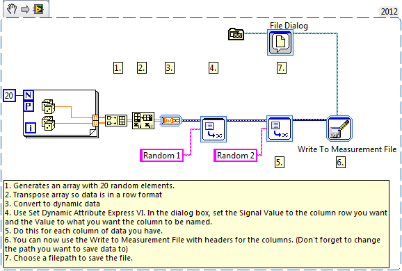

This example code shows how to add headers to the Write to Measurement File when the data type is not a waveform.
Description

  1. Run the code.
Additional Information or References:
No front panel actually.
