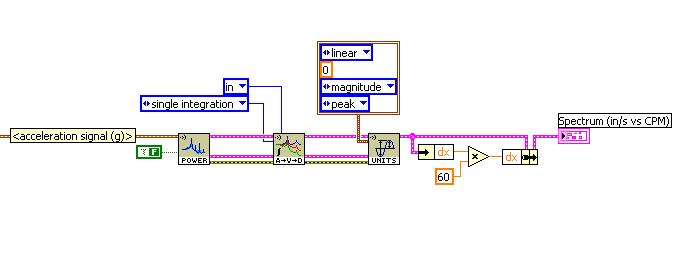

If you are able to successfully generate the velocity vibration signal, you can use the SVT Power Spectrum VI to convert that to a spectrum. The frequency resolution and maximum frequency in the spectrum are determined by the sample rate and period of the simulated vibration signal. You can use the SVL Integration (frequency) VI and the SVFA Unit Conversion VI to help you achieve the correct magnitude units for your spectrum. Lastly, you will have to convert the frequency units from Hz to CPM (Hz=CPS --> CPS*60=CPM).

If you need access to the time-domain velocity signals, then you must perform the integration on the signals before performing the power spectrum. If you only need the velocity vibration spectrum, I recommend that you perform the integration on the measured power spectrum. The time-domain filters used to implement the integration require a certain number of samples to settle whereas the the frequency-domain integration is just a frequency-dependent scaling of the spectrum (no filters means no delay, no transient behavior, and perfect frequency response). If your DUT has already reached steady state when the VI acquires the data, you could simplify your code by integrating the power spectrum and removing the Express VI that gets a subset of the signal.

In the VI case, you can right-click the power spectrum VI and select the type to be 1 Ch.
The x-axis scale will have the correct multiplier if you bundle the dx*60 back into dx (it is bundled into x0). You will have to change the x-scale label text yourself (to 'CPM'). Technically, we should also multiply x0 by 60, but x0 = 0 for the baseband power spectrum.
As for your units concern, at 60 Hz 1 mil pk-pk should result in a velocity level of 0.1884 in/s pk. This should be evident in the time-domain signal, the peak of the spectrum, and in the vibration level measurement. I see exactly this value when I simulate an acceleration signal with amplitude = 0.184 g and frequency = 60 Hz. It does not matter which order I put the integration, power spectrum, and units conversion. Does your acquired acceleration signal have a peak amplitude of 0.184 g? Is the Subset Express VI removing all of the transient response? This would be helpful data to show also.
