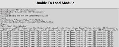

I deleted the project, got it again from the repo and it doesn't crash now, but now after loading the file the custom modules say they are unable to load. Any ideas? I am loading the same files from the repo on another computer and the modules do not fail to load:

ok, I figured out my issue. I had to add edit the path to look for the file path that the custom modules are located in.

Make sure you add the custom module paths to the configuration editor under Tools menu.
