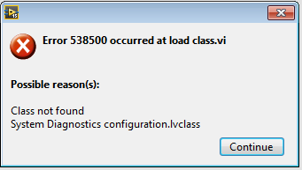

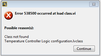

I'm trying to evaluate DCAF for a customer,but the installation seems to fail on a fresh LV2015 install.
Installing DCAF core went OK, so does opening the example.
But when I launch the DCAF editor and try to open the example configurations I get the follwing error for the simulation config
Loading the FullSystem config gives me another error
I also cannot specify Linux x64 as TargetType in a new configuration, but I'm guessing this is due to the same iisue I see with the example files (something missing in the installation?)
I'm probably missing something big, but any help is greatly appreciated.
/J
Message 14 of 30
(6,565 Views)
Hi Mellroth,
When you open the DCAF Configuration Editor, make sure to include the appropriate search paths for the example folder. This allows the editor to load the classes it will need. Do this by going to Tools>>Edit Plugin Search Paths. Then click "Add" and navigate to the Example directory which may look like this:
C:\Program Files (x86)\National Instruments\LabVIEW 2016\examples\DCAF Examples\RT Temperature Controller
