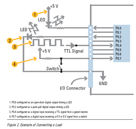

I am considering purchasing the 6501 and I just wanted to make sure it will fit my needs. I am looking for a product that will let me connect multiple (10-12) sensors. Each of these sensors is actually a magnetic reed switch. I am interested in monitoring switch closures. I would like to be able to see the data as number of closures (for each switch) in a given time period, but it would also be acceptable if each closure was time-stamped and logged. Is it possible to connect this type of switch as a sensor, and if so, will the 6501 fit my application?

It looks like what you want to do is shown as #4 from this figure in the 6501 data sheet. You don't mention how often you need to check the switch closures and as the acquisition is software timed, the speed will depend on your system and your program. You don't mention what programming language you will be using but assuming that it is LabVIEW, you can acquire data as a digital waveform type which will give you a timestamp, add your own timestamp whenever you do a DAQmx Read, or put your acquisition in a timed loop which will give you a more reliable rate.

Thanks for posting the NI Forums.  I wanted to add to Dennis' excellent advice by mentioning some of the additional limitations that may arise with the USB-6501.  The USB-6501 is a static (software timed) only digital device.  In other words you cannot specify a rate of acquisition in hardware but only use software polling.  Some typical acheivable data acquisition rates for the USB-6501 can be found at:
http://digital.ni.com/public.nsf/websearch/376BBB979269F9C5862570F7006A030F?OpenDocument
To answer your question: yes, this type of system would actually check as some interval whether the switch is open or closed.  This is the case with most digital data acquisition systems.  The key is to acquire at a fast enough rate that the information you care about is preserved.  For example, you will want to acquire faster than the fastest rate at which the reed switch can change state and thus acquire the actual state of the switch during your acquisition.  If acquired at a lower rate you will miss transitions.

And on the other side of the coin, if you sample too fast, you may end up detecting contact bounce of the switch. Switches rarely close 'cleanly'- that is the contacts may tend to bounce close and open many times before it settles down to a solid close. Depending on your detection time needs, you could use hardware RC filtering or software filtering of some means. Mercury wetted reed relays are another way to go, the liquid nature of their contacts allows clean closes and also a self-renewing contact (it keeps clean, no oxide buildup).
