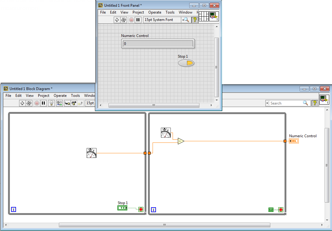

It sounds like your main question is how many clock cycles would occur between the end of one while/for loop and the start of another while/for loop. Is that correct? Could you provide a screenshot of your code so that I might have a better idea of what it looks like?

Unfortunately, there's no real way to tell how long that time is going to be due to the nature of how operating systems handle tasks. However, it's going to be extremely fast. Even with our most precise time measurement, it says that there is 0 time between the two loops.
