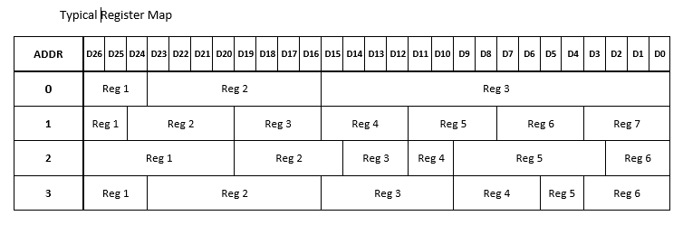

The first image I want to show you is an example of our SPI Interface.  It shows the SPI Interface in relation to the Registers.  The SPI packets are 32 bits in legth, but the register data is 27 bits in length.
SPI Blk Dgm Example.PNGThe next image breaks down the 32-bit SPI packet to show how our write data is constructed.
The 4-bit address is the register address.  An example of what the I'm calling the Register Map provides details of the 27-bit Data field, and is shown in the next image.  The 27 bits in the Register Map comprise the 27-bit Data field above.
And finally because the image is too big to be included inline, I've attached an updated version of my experimental front panel, so please refer to it for the following discussion.
I've kludged my experiment so that the MISO and MOSI data are the same and are coming from the Input Array.  Looking at the MISO data, starting around sample 1 is the MSB and it is the R/W bit.  The next 4 bits are the address bits, and the final 27 bits represent the Data field. I parse that full 32 bits of data into the various sub fields, and then further parse the 27-bit Data field in the register data, which I use to fill in the Output Array.
The code all works as expected offline.  My question is will it work in reality.  Will SPI Library's SWAP.vi actually work in full duplex and return what's in the registers, or do I need to break this up into 2 phases where I write to the registers using the SEND.vi, and the read back the registers using the RECEIVE.vi?
Sorry this got a little long winded.  I hope this helps to clarify what I'm trying to do.  And thanks for the help.
Bob
(5,301 Views)
