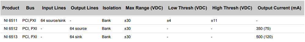

Hello Everyone,
I have PXI 6511, 6512 and 6513 digital I/O modules. The datasheet information is the figure above. I want to test these modules before start my project. I used NI MAX for the test. I can see my modules where their own slots in Devices and Interfaces (like this).
For example about PXI-6511, the connection in the figure below is established using pins 1 (+) and 9 (-) by applying a constant 12 V or 24V voltage. In test panels, i want to see a LED always ON (HIGH). I used port0/line0 for the test. But there is no any change.

From the simplified circuit diagram of 6511, it looks like inverted logic i.e., no signal = high (pull up to 3.3V) and signal = low (pulled down by the opto isolator) unless the rest of the logic takes care of inversion.
