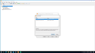

I have a setup as follow,

Our Architecture is to communicate the IO with Kepware KEPServerEX 6 via Modbus TCP. In the older IO we could do this via MAX once configured we can already assign address, however now we have added the IO via LabView (image below) but can’t seem to get it on KEPWARE over MODBUS TCP.

  2. Do we need FPGA or all can work on Scan Interface? As for NI9361 would indicate not supported in Scan Interface (image below)

Hello Haizam
Considering on the message below about NI-9361 unsupported scan interface, yes, you should have NI LabVIEW FPGA interface programming mode to develop you project.
For the question "Is there a Modbus Master or Slave (server or client) built into the NI 9149?" try to go through this article to find appropriate information.
