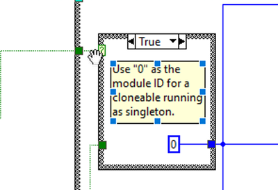

0 is used for cloneable module running as singleton 🙂

How could I miss that? Thanks man!

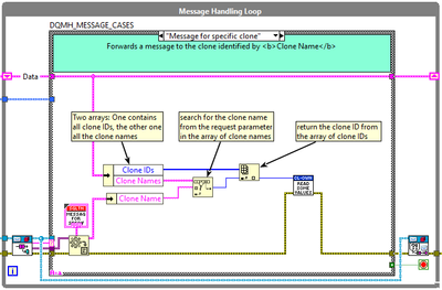

DQMH handles the dispatch of clone IDs internally: The framework decides which ID a new clone instance is assigned. Depending on the order of starting clones, or stopping and starting them while your program is running, the clone ID might or might not match its "identity" (what you want the clone to represent).
So instead of relying on static clone IDs (which means you always have to start them in the exact order, and never stop and restart them), it makes more sense to have a clone registry where you map the name or descriptor of each instance to its clone ID.
Depending on the requirements, we usually create a clone manager which takes care of starting clones, telling them what to do (i.e. handing over some sort of configuration), and keeping the "name to ID" relationship in the clone registry.

I don't want to sound condescending or arrogant or stupid-in-any-other-way at all, but it seems to me you're overthinking this. All you need is a simple lookup table. Whether that is a map, two array, a variant... doesn't really matter that much.
1. when you start a clone, you assign it a name and store that match ("name" -> id) in your lookup table
2. if you need to interact with that specific clone, you look up the name and then use the linked id
3. when you stop the clone, you remove that entry from your lookup table
The most basic implementation (I think) is a set of two arrays: Whenever you start a new clone, you add the ID to one array and the name to another, so that those two matching values live at the same index within each array. I just threw this together from scratch to illustrate the idea of a clone manager:
