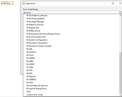

@Konan__ wrote:
What is the difference between the "Error cluster from error code" and "Error Ring" with custom error code?
I noticed that the latter builds up on the internal database of installed errors families + all the additional error codes files installed in user.lib (you can define ModuleX--errors.txt, ModuleY--errors.txt, etc...)
On the error ring scroll down to the Custom error codes, you can add your custom error code but more importantly, you can use string formatting and create new inputs, this allows you to give timely information on your error. Here is an example:
@Konan__ wrote:
Why do you create multiple VIs just for constants.... instead of concentrate all error numbers in 1 single VI for the entire module?
One major reason: "Find all instances". With an error VI, I can right-click on the VI on the project and find callers. I can right-click on the icon and find all instances. Most of the time, while I am debugging, I want to find the places where a certain error occurs.
Another reason is the additional information we can add to the error like the example above.
I hope that helps.
